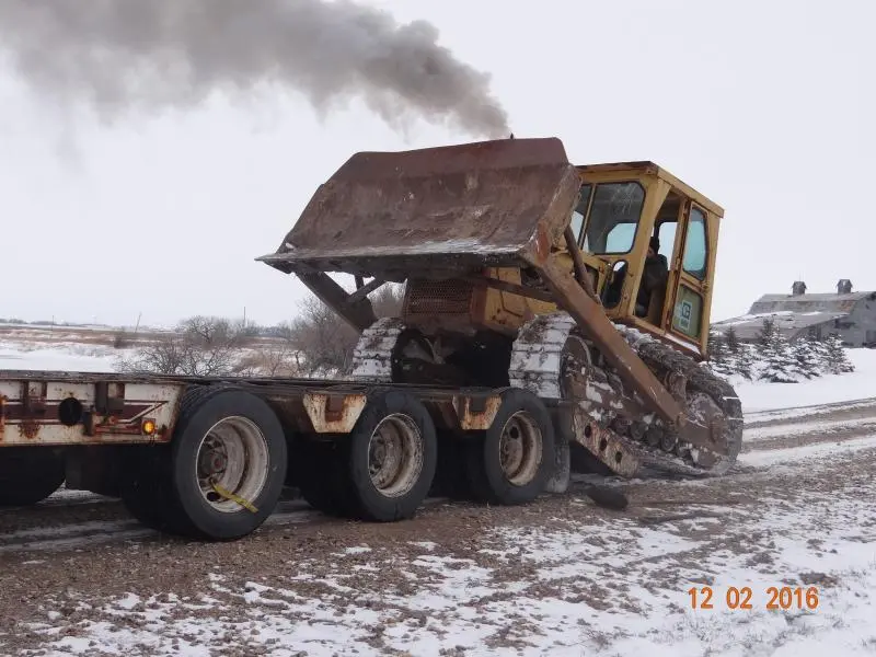

I have an older D6 I just bought last fall. This machine has an engine problem, and great running gear, so I took a flyer on it. The engine smokes black under load and has less power then it should. The previous owner threw money at it to see if any would stick, but the problem remained.
He told me the engine quit and would not start, so he rebuilt the injection pump, put in new bullets in the injectors, and did a valve set.
It still would not start. Burned out the starter, so he replaced that and a couple brand new 8D batteries were put in.
Upon further investigation, he found the turbo completely plugged with carbon til no exhaust could get through.
So he cleaned out the carbon, the engine started, and he assumed it had a burnt valve and decided to sell it.

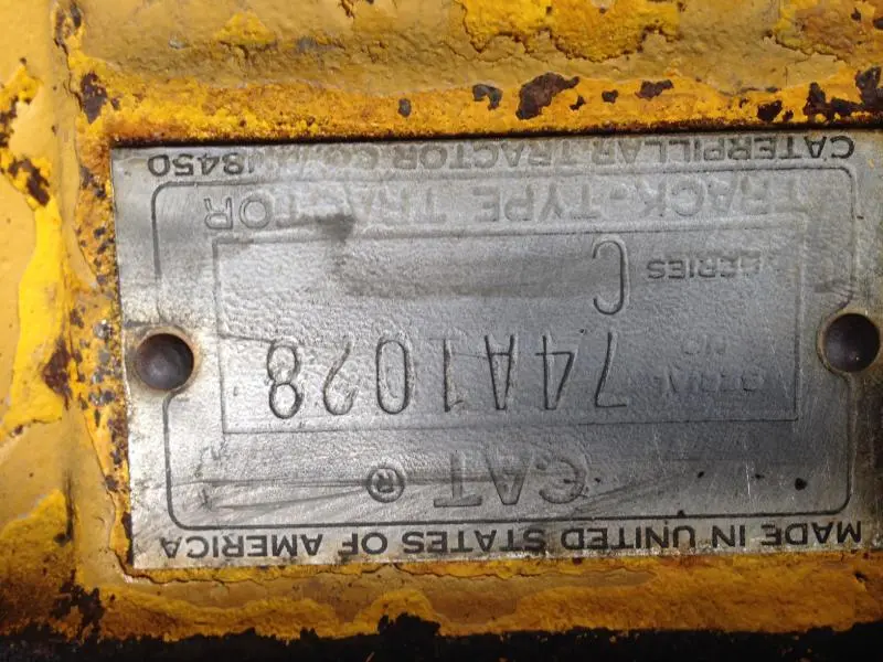

So here is my question. I am told by the seller that this is a D333T engine, and I need to really verify that somehow. I also need to know the current number for valve guides. I have yet to mike the stems, but I may need valves too.

Definitely is a D333T engine (4-1/2" bore). Valve guides are #5M8023 until you get to s/n 74A2467-up where they change to #5S4507. Early guides are flanged. Replaced by 4N3668 ( no flange)

Have included pictures of the engine plate, and I don't know if there are any numbers that should come after the Series C or not.

On your injectors....
74A1 to 1574 originally used 180 deg. counter bored nozzles Valve Service Group #3S6638 which contained #2S4442 nozzles.
74A1575-up originally used 90 deg. counter bored nozzles Valve Service Group #8M1584 which contained #5M4086 nozzles.
There seems to be a lot of confusion out there on whether nozzles are referred to by their correct part number or Valve Service Group part number. What reference I have may indicate your 8N5986 is a 2S4442 equivalent but I am not 100% sure. The 8N4694 does not appear to be a candidate.
