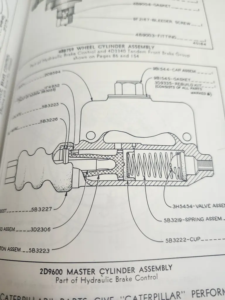

Anyone know of the NAPA part number for this (wagner?) master cylinder?

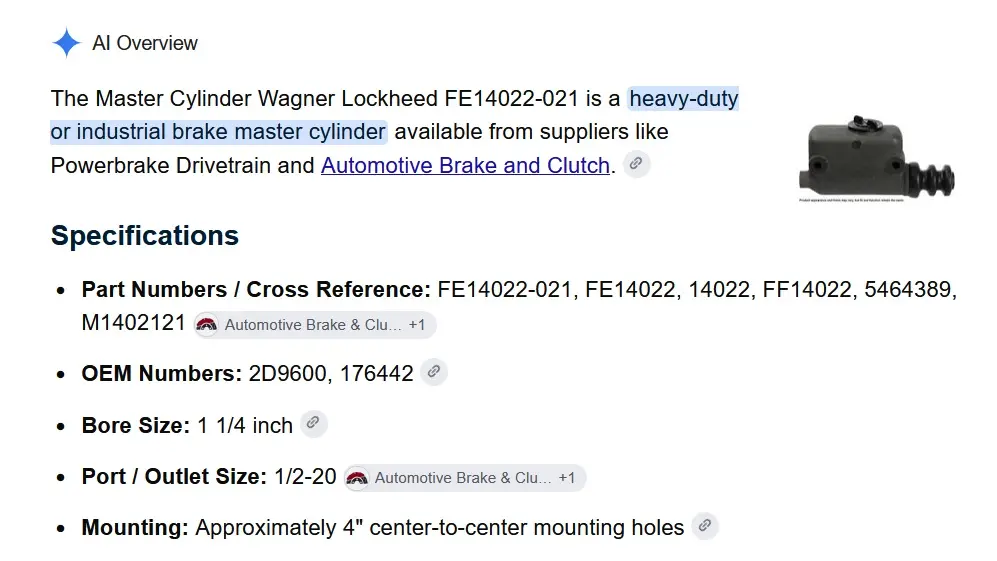

From the image, the master cylinder is Caterpillar 2D9600. It cross-references to Wagner FE14022-021 / FE14022 / FF14022. I couldn’t confirm a NAPA number for it, so I’d give NAPA the 2D9600 or FE14022 number to cross-reference.

NAPA was no help. But powerbrake and drivetrain had one for $224 plus shipping. Cat wanted $394 plus shipping.
