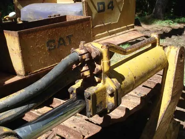

Anyone have any idea where to get these seals? CAT?[attachment=35332]D4-Oct-3g.jpg[/attachment] This is a photo of the same Rams I have, my manuals have no seal serial #s
