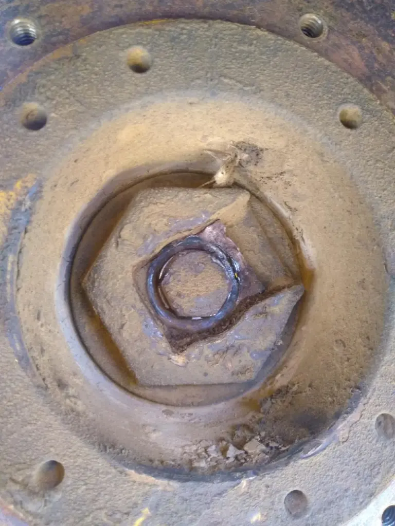

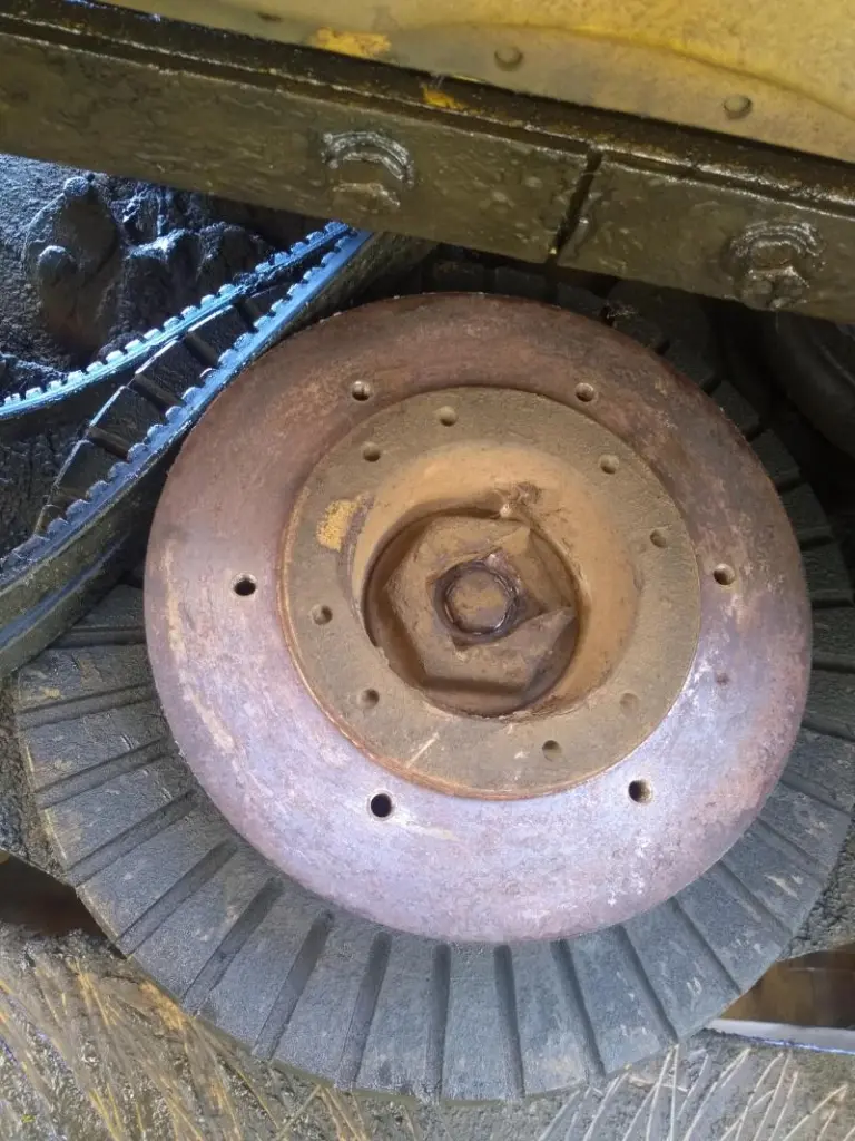

This is the front balancer on 583h # 61A89. The 5/8 bolt won't turn out even with a 3/4" impact. This isn't left handed is it? I hit it clockwise a few times. It won't budge. What am I missing?

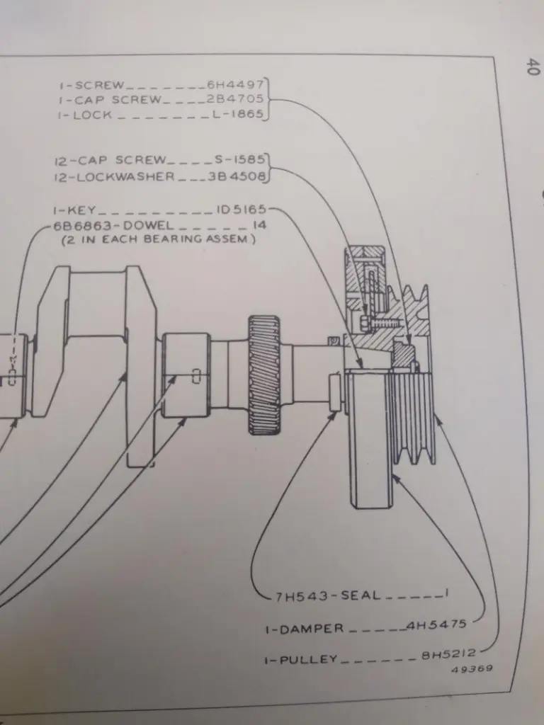

This is the breakdown. Seems simple. I guess I need a stronger impact.
Left handed
Wed, Aug 29, 2018 3:22 AM
Reply to frictionman:
Left handed
"Yep that bolt is left handed"
