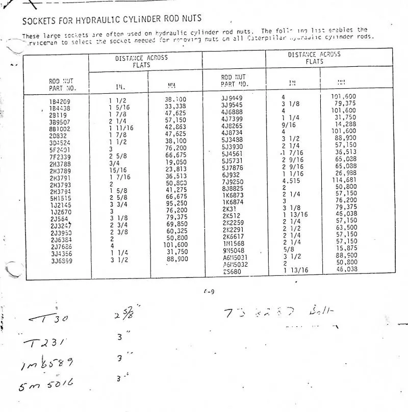

Recently acquired a D7E serial 48A9088. Working through all the filters and fluid flush / change and will be starting up on the hydraulic cylinder rebuilds soon.
Question: what is the nut size for the lift cylinders and the tilt cylinder? Want to have tools on hand in advance.

Uh, thanks I guess and am good on calipers, what nots well beyond the wrenches you listed.
If someone actually knows the nut size on a D7E tilt cylinder seal set / packing, would appreciate a substantive response.

Why would I take to a shop if routinely rebuild cylinders myself. Just asking if someone knows the nut size for a 48A D7E so I can be sure to have it on hand when I take it apart.

Since you are a hyd expert you should know that it is recommended to replace the piston nut or bolt as the case may be .
So when you order the packing kit order a new one and pick up a 1" drive socket one the way home.

It's a nut on the D7E Bob. But thanks for the knowledge share.

This list should help:

Old Magnet - can you repost ... the list did not populate. Thanks.

Once more an last attempt!!!!
