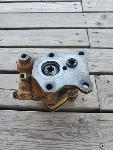

Well i have some definitive info about the old girl now. I was finally able to get in front of it and pull the fuel transfer pump since the last information i had from the owner was the worm drive gear (accessory shaft gear) looked stripped.
So, going on that info, pulled the pump, and to my surprise i found there was NO drive shaft/gear in the fuel pump, and the accessory shaft worm gear is just fine. Not sure where he got that fuel pump, but it wasn't refurbed apparently. Certainly a head shaker.... (picture attached)
Any thoughts as to where i might find a refurb fuel pump for 5J8143? I'll start by calling the local Cat dealer and go from there. I'm in the Spokane Wa area.

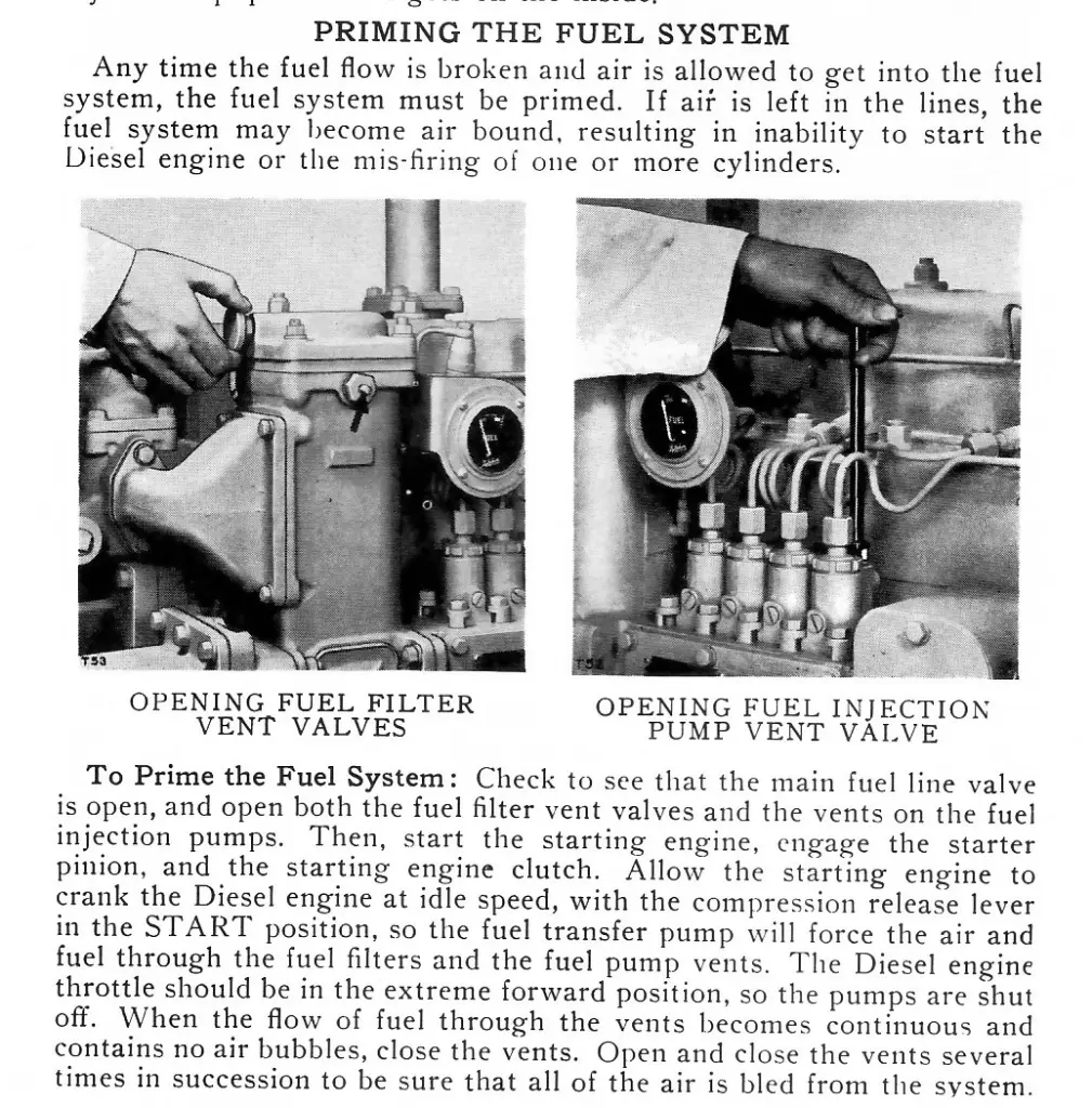

Hi Team,
the scan below may help.
If the mounting gasket for the transfer pump was not a specially cut one and so was covering the T/pump's drive shaft hole then fuel would gravity feed into the engine lube system and dilute the Diesel engine lube oil and also would drain out of the T/Pump drain line if indeed it was not already clogged by dirt daubers etc.--check your Diesel engine oil for fuel dilution before running it or you will risk failing all your crankshaft bearings in quick time.

Reply to edb:
Hi Team,
Thanks for the scan & info. I'm guessing the priming procedure is in the service manual... which i should be receiving soon.
