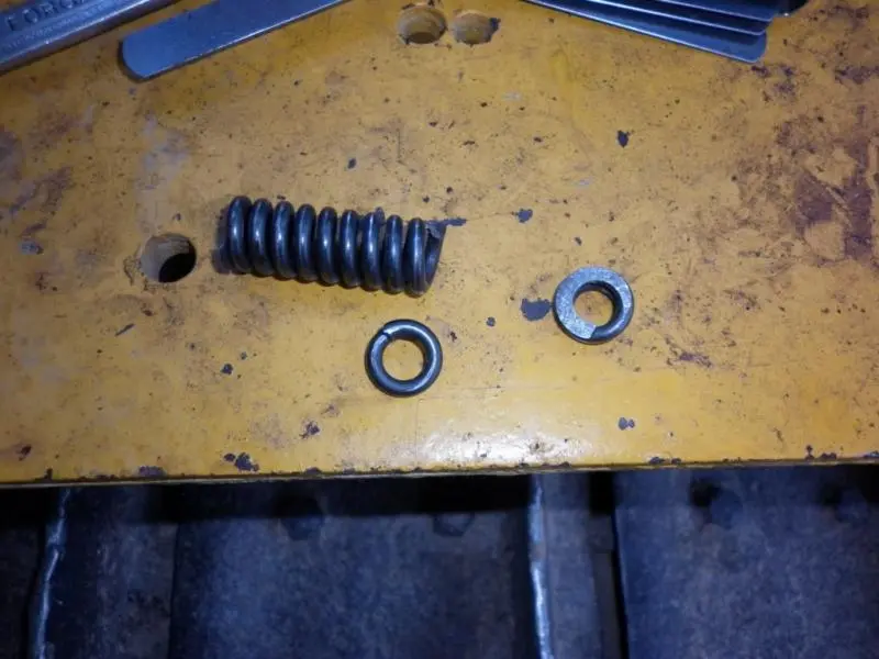

Can someone please give me a rough idea of how thick the shim stack should be in a #41 hydraulic pump pressure relief valve, I'm struggling to get any pressure on my rebuilt pump above 100 pounds and I now suspect the shim stack we found in there when it was initially dismantled was not right, but when we found a broken spring I wrongly assumed this pump was going to be an easy fix.

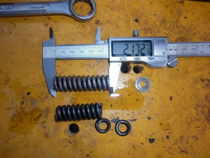

My Cat Hydraulic systems book has a reasonable photo of the pressure relief valve and using my micrometer it looks like the shim stack in that #41 pump is about 10% of the total spring length, I know it is not precise but it is a starting point for trouble shooting, the new pressure relief spring the Old Magnet directed me to from Cat appears the right size compared to the old broken spring, the new one is just over 2" long yet my shim pack made up of 4 thin shims is only around 50 thou thick and I suspect it needs to be 5 times thicker as a starting point for pressure testing, if it helps the part number on the pressure relief housing is 1H323.

Seems you have the spring number mixed up.
Original shim pack was 8 shims but I can't tell you how thick.
Shim away, your not going to hurt anything. No telling what had been previously installed.

Thankyou Pete, just what I needed, that parts diagram confirms I have the right spring 1H0332 (again thanks to you) though even with the "washer" and 8 shims the original spec is no where near 10% of the spring length I was thinking I could see in the Cat Hydraulic Systems book, I'll start adding extra shims and see what happens, luckily it's only about 20 minutes work to open up the pump.

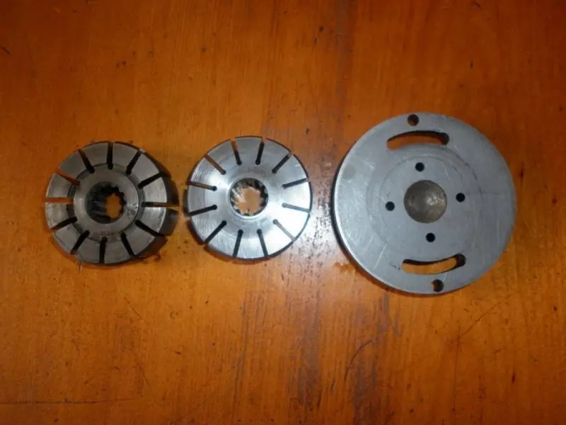

Hello Catsilver, thanks for chiming in, this #41 pump I have fitted to my D2 5U has been a major pain in the ring gear from the start and I've had 2 hydraulic pump experts work on it including the Owner of the local hydraulic shop and a semi retired Cat Mechanic, both who were confident it would work but I'm just not getting any pressure.
I found this pump at the back of a shed covered in dust and with the help of "Edb" we pulled it apart last year and Eddie found the broken pressure relief spring which gave me the wrong impression about it being a possible easy fix, the shaft bearings were worn out so I got the local hydraulic shop to replace those and the seal at which time he pointed out some nasty water damage in the cam ring, he said the pump "should" work but with that water damage he wasn't sure how long it would last, but through my own stupidity later on by fitting the pressure relief valve plunger in ass backwards the pump wouldn't develop any pressure, so I sent it over to a nice semi retired Cat Mechanic interstate who said he had a new cartridge kit for a #41 pump I could have, though when he got my pump in his hands he discovered his #41 cartridge kit was actually for a different pump and wouldn't fit mine, so we were back to square one, after hunting all over Oz he did find a new rotor and hand lapped the scored end plates and reassembled the pump saying it should work well but sadly it didn't develop any real pressure and when I took the pump apart after about 8 hours running found it was making metal filings, I had shown him my spool valve when I picked up the pump and he thought it all looked OK.
When I later pulled the new rotor out that had been fitted and compared it to the old worn rotor I discovered it did not have the 2 oil "galleries" machined at the base of the vane slots (see photo) so the vanes were hydraulic locking in their slots and cutting the cam ring and end plates so I got my Fitter and Turner neighbor Geoff to machine 2 oil 'galleries" in that new rotor and refitted it all after triple checking that the vanes were fitted with the rounded ends outward and that the cam ring was aligned correctly, incidentally there are all new rubber O rings in this pump. I had also measured the vanes carefully as a couple were tight in the new rotor(one vane was over one thou thicker than the others) so I hand lapped it so all the vanes were identical and slid easily in their slots, I'd also bought a new cam ring off Fleabay in Canada 2 weeks ago and fitted that so I was pretty confident I had all the obvious issues fixed now and so refitted the pump yesterday and found that while it will push oil even at low idle (previously it wouldn't, only at high idle), it still does not produce any real pressure so all I can think of is the pressure relief valve is allowing oil to be dumped before any real pressure is developed.
Needless to say this pump is driving me nuts, I've had it apart 6 times and 2 experts have worked on it and told me it should be OK but it is not, so I'm open to any ideas.
Mike

Are you sure you have the vanes installed correctly.....and what viscosity oil are you using?
