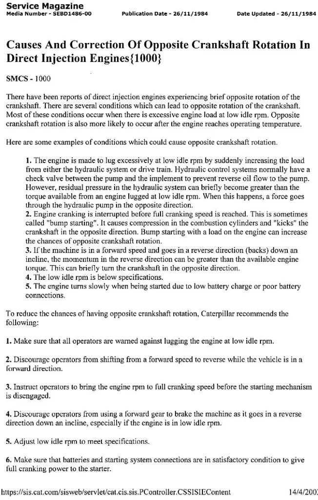

usual cause of soot inside the inner air cleaner element is that the machine was stalled on an incline in a direct drive and allowed to run backwards down the incline--the engine can start and run in reverse rotation direction ,BUT, you do not know it until the gears and hydraulics do not work--the soot does not come out the intake on dry air cleaner machines as the inner element does its job of catching the soot.
With old oil bath air cleaners you got oil soaked boots or worse.
Sometimes at low Idle if the hydraulics are stalled the engine can stall and the hydraulic system pressure can start the engine backwards too.
Have a Cat article scanned somewhere on the subject.
Even though the article is for DI engines it can happen with PC engines too--they may not necessarily have to start as they will make black smoke if driven/forced to turn backwards.
With the DI engines cat altered the injection pump cam lobe profile to stop this occurring.
