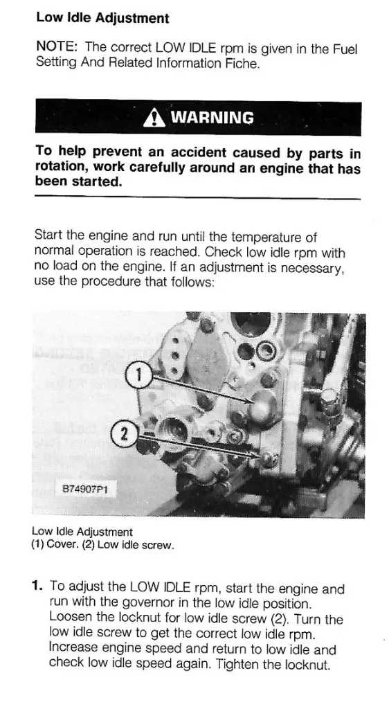

Hi PhilC,
your engine has what Cat call a New Scroll Injection Pump.
With the Governor control you have I assume the L/I function is set by engaging one of the Gov control detent grooves---the L/I screw on the rear face of the Gov Hsg. will likely be screwed out a long way--some engine applications do not allow for a L/I condition to exist--eg. Gen set.
The actual L/I screw position is on the rear face of the Governor housing towards the outside of the face below centre line of the Gov. control--see scan below.
I do not have Rack setting specs for these late model machines.
Hope someone else can help out, but I guess somewhere around 650 Rpm should get you a start point--I often found we had to adjust the L/I up a bit more than spec for some applications to stop the exhaust pipes etc vibrating--adjust as needed to get smooth running.
You may need to check with the Dealer to see if your engine Arrangement Number has the required extra oil pump scavenge pick up section gears and pickup tube and screen--if indeed it is even needed in your 955 application.
