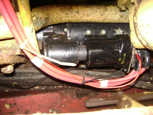

I did as you suggested and contacted “Rareelectrical.com”
They were over the top helpful in every way.
After a few photos and telephone conversations they sent me exactly what I needed.
The final price was $497.30 including changing the helix gear and shipping.
[attachment=9243]DSC02758.JPG[/attachment]
I had a few problems fitting it.
First the solenoid index wouldn’t work because there was no clearance between the solenoid and the oil filters.
I eventually ground away one corner of the solenoid until it fitted.
And second,
The contacts in the solenoid kept arcing and welding themselves together. After a phone call the solution was not to keep starting the engine six or seven times to see if it works, but to, as they put it, “live in the real world”, start it up and let it run for 20 mins. to recharge the batteries...
The voltage drop was creating too high amperage....
And now it’s perfect, the engine starts like a spring lamb, In the 25 years I’ve had the boat she has never sounded so good...
After 5 years of aggravation with the starter motor I’m now as happy as a new born.
I highly recommend Rare Electrical, “Rareelectrical.com” Tel: 866 695 0363
Thank you again and thank you Antique Caterpillar owners Club...
And second,

Glad to hear you got it done!!!! That's a tight fit and why I was asking where the starter was mounted. If the solenoid continues to give you a problem there are units available with upgraded heavy duty contacts. Looks good and like it belongs.
Sorry, I don't recognize that transmission but if it is multispeed there may be shift rails with lockout mechanism that only allows engagement when clutch is in neutral. If the rails and detents get worn it will sometimes allow two gears to engage at once which locks it up. Usually means adjustment or removing a cover plate or shift tower to pry bar them back where they belong. That transmission seems unusual for a marine application which is usually forward or reverse and maybe a second speed.
