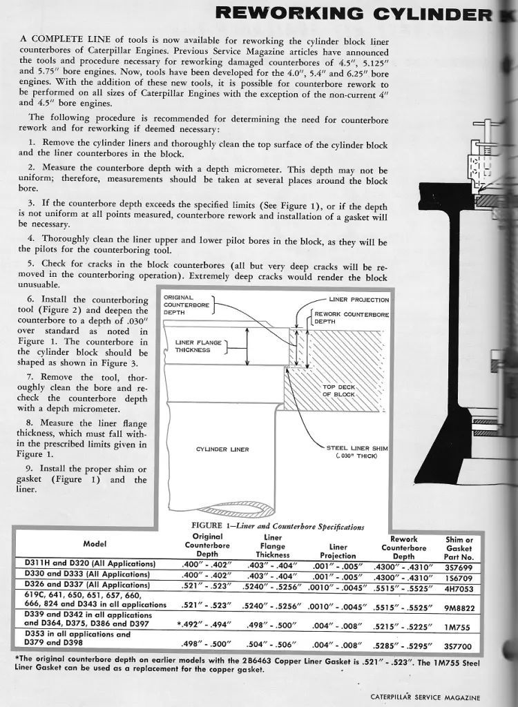

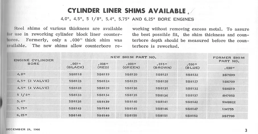

here is a few Cat articles on the subject--general protrusion for early engines was given as 0.001" to 0.005" with a maximum difference between any two cylinders as 0.002"
Hope these help--

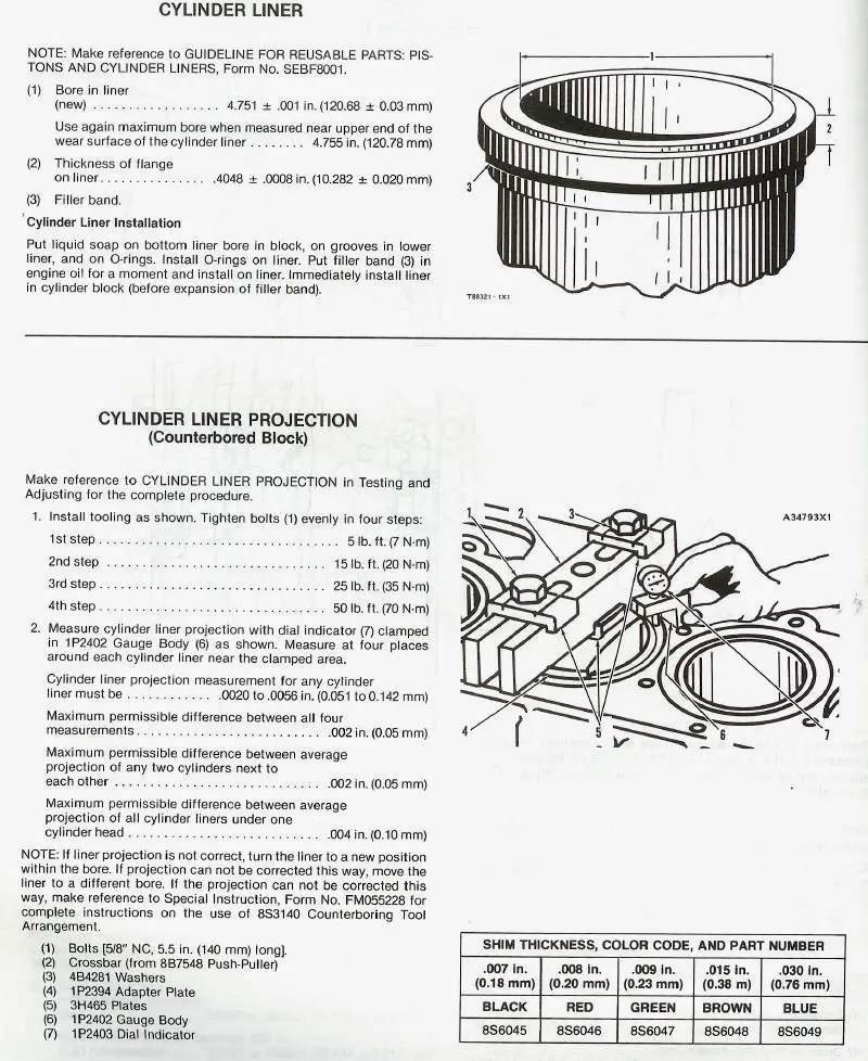

This page from a 3306 engine manual describes how to properly measure liner protrusion--a depth mic. or careful use of a digital vernier caliper at a pinch can be used as these were the tools before Cat came out with the gauge shown.

I have always measured liner height with a small engineers square and a feeler gauge. I made a tool to hold a dial indicator like in the picture but someone wanted it more than me so back to the old way of doing it.

thanks my heights fall within those specs I'm having trouble with number 4 cylinder pressurizing the cooling system i was sure it was a liner height issue i just done new liners and rings on this engine I've also had the precon chamber seats machined thinking it may not be seating rite there doesn't appear to be any cracks in cylinder head I'm slowly running out of options
