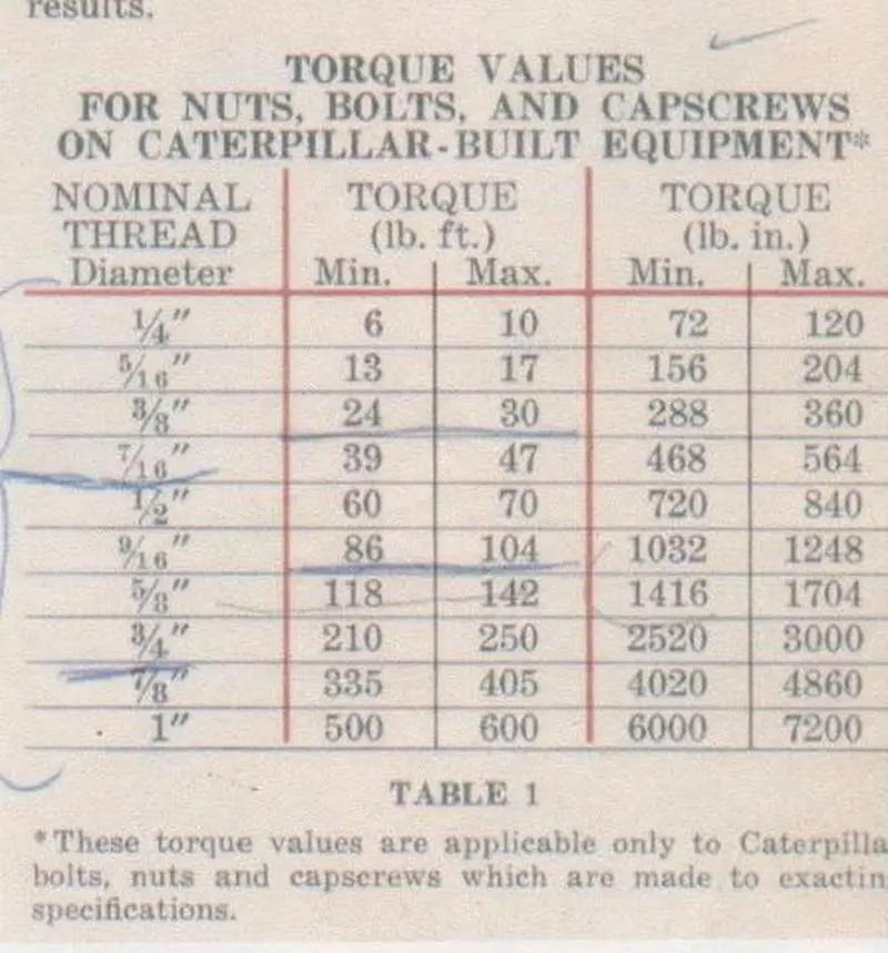

Working on my 30 and 60 and need to know what to torque head studs to. Thank You
Tue, Sep 3, 2019 12:33 AM
hfdzl
Posts: 607
Can use Gr 2 torque and go by diameter also
[attachment=55194]bolts_torquesettings_501_640.jpg[/attachment]
Tue, Sep 3, 2019 5:14 AM
crawlerholler
Send a private message to crawlerholler
Posts: 18
Reply to hfdzl:
Great information to have on hand. Thank You very much!
