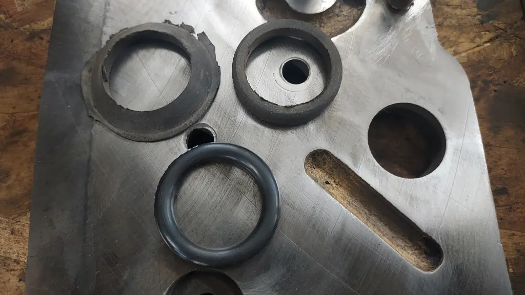

For anyone curious this is a front fuel galley o ring ,a rear uuel galley o ring and a new Cat spec o ring

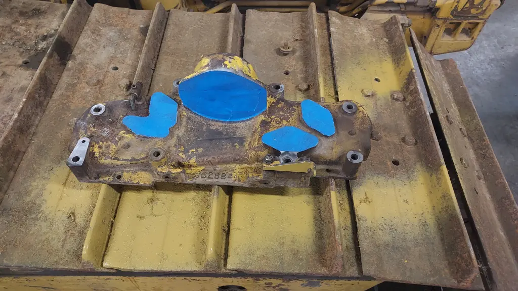

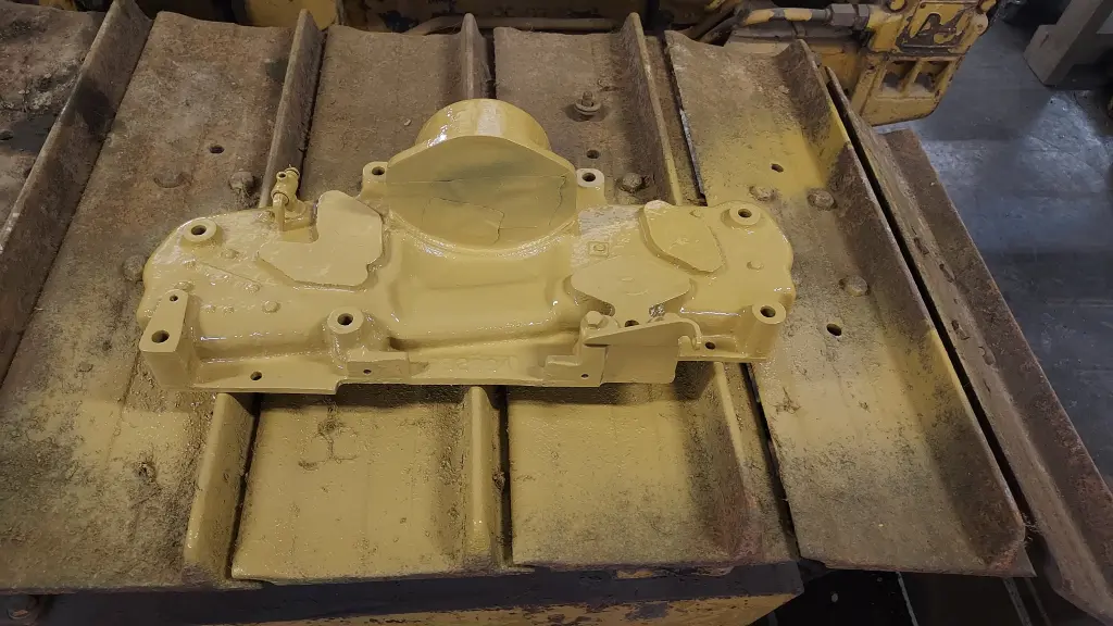

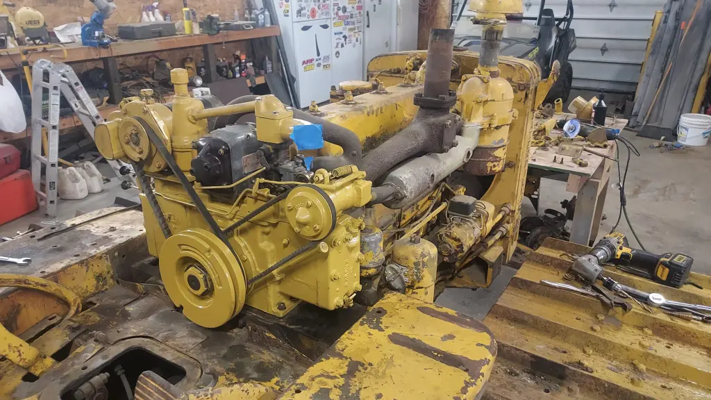

Gaskets came from Olsens gaskets. Still waiting on one seal for the injection pump but it's supposed to be in on Wednesday. Basically have a complete starter motor with electric start ready to go. It will get a final coat of paint before it goes on. I am going to be drilling the bellhousing for DE starter, I have the starter and solenoid on a parts tracker. Not sure what I'm going to do about a charging system yet. I have a couple of options.

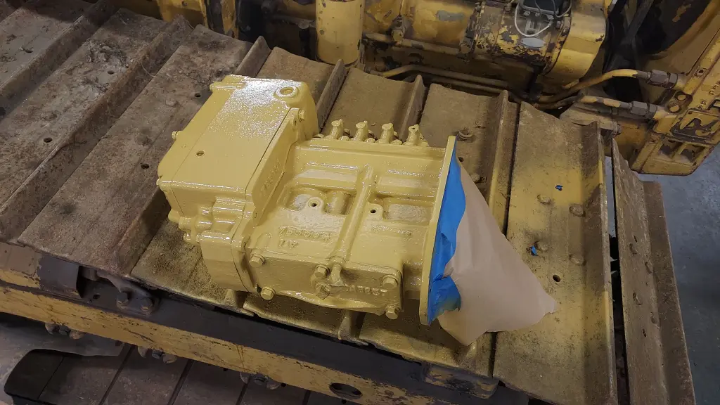

Injection pump cleaned and resealed.

Wow, looking better each day. What voltage are you going for on the DE? 24v or 12v? Thanks to the talented mechanic that does a lot of my projects, I have several machines that utilize pony or DE. Very fortunate that several will start up without an aid, as I did not have heads swapped over to glow plugs. Thank you for sharing.

The starter on the parts tractor is 24 volt so that's what it's going to be.

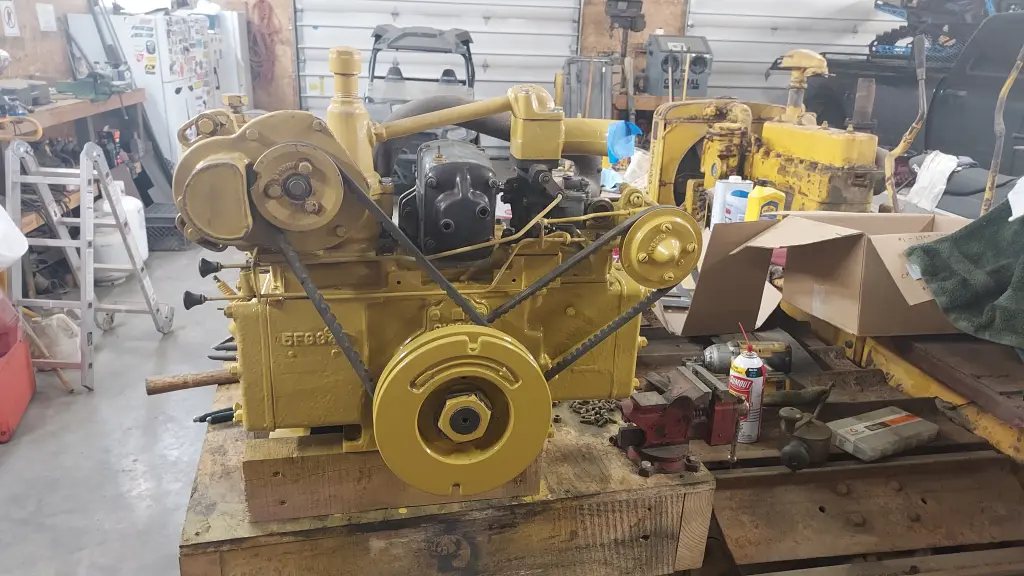

Spark plug wires on order from Brillman company. All pulleys and belts installed and final paint done

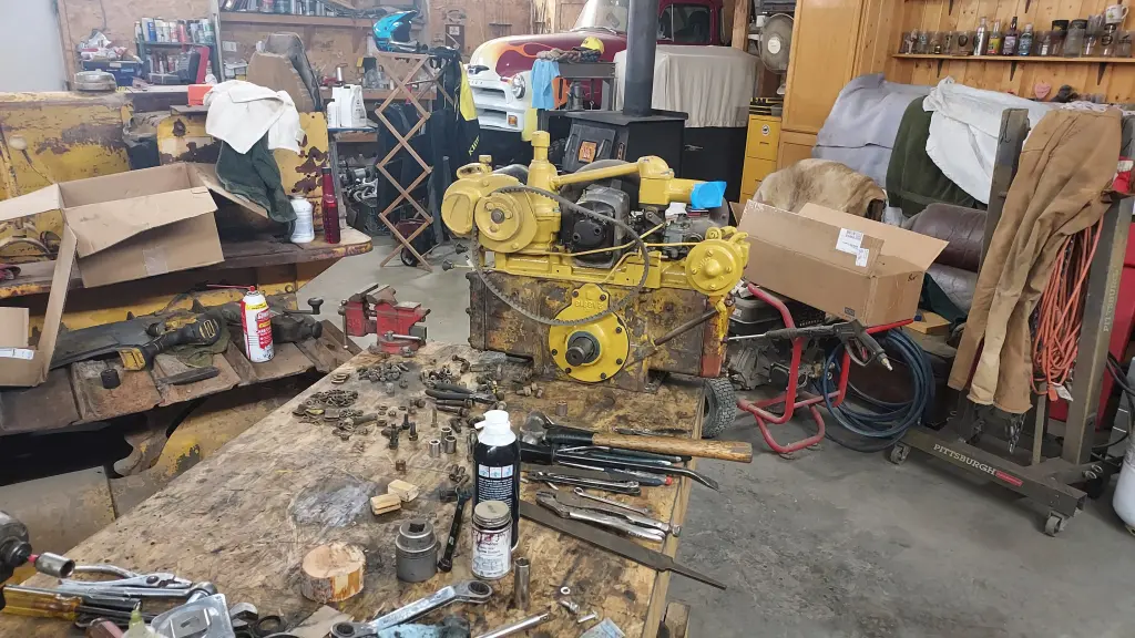

Starter motor set in place. I really don't care for the fender tanks and this one was really cobbled on . Took the fender tank off and will be going with a seat tank
