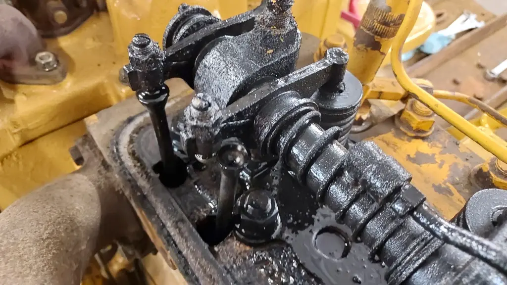

Well it's a no start. Had good fuel to the injectors and moved the decompression lever to run. The load didn't seem to change so I shut down the starting engine. Discovered the crank seal went out for some unknown reason. Took the rocker cover off to check the decompression on the valves and found number 4 intake valve pushrod not in the rocker arm. Looks like I've got some more work to do.

Crank seal on the pony or the main engine, Scott? Nothing like a good mystery to solve. My guess on the rocker is a combination of a loose adjustment combined with a sticking valve. The seal could be something like over-pressure in the crankcase or it could just be worn/decomposed I guess.

It was the starting engine seal that went. It ran upon start up and them while I was tuning the carburetor. Then when I started bleeding the injectors it ran for some time before it let go until I shut it down. Luckily I caught it before all the oil was gone. About half a quarter leaked out.
