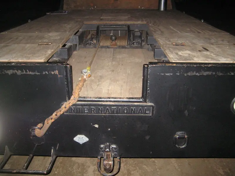

On long runs with the Brownie box in OD the Brownie starts getting hot 275F. They make additional oil coolers that increase the capacity by simply bolting were the pto rides. My rear winch is driven off the pto and the pto gears always turning creating more heat. I thought of removing the winch pto and putting an oil cooler on.
I was thinking of using a starter motor for the winch but would it turn in reverse?
Any suggestions?
