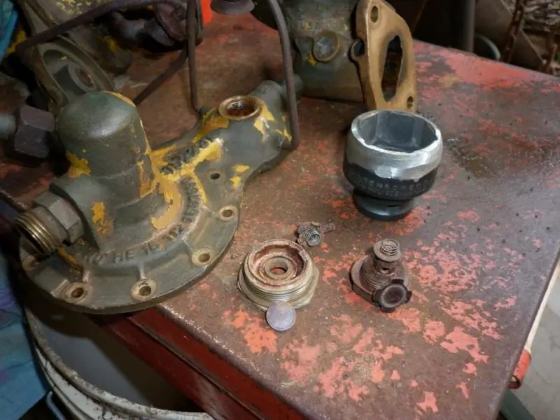

Mike,
I too working on fuel pump for a Cat 22 and found the same rusted valve part in the chamber above the diaphragm. I bought the kit from Then and Now and while many of the parts are useful (and I'll keep the kit) it's not an exact match. I did supply the casting number (2151.) I called Then and Now and discussed the situation but they do not have this part. I am trying to figure out the dimension so that I can machine a replacement, and I'd be more than happy to share my drawing when complete. But I am having a tough time figuring out exactly the clearances. I assume the small round disc in the valve is held in the closed position by the spring and moved up by the output action of the pump diaphragm. The disc has to be big enough to cover the hole but small enough to allow fuel to pass by and out the top of the valve when unseated. And I assume there was a detail inside the valve to prevent the disc from topping out and blocking the fuel flow. Any insights or other pictures of the rusted part are welcome. Also, can you measure the diameter of the disc and let me know?

Sorry for not replying sooner Paul, I have been Stateside for the past 4 weeks and only got home yesterday, I'll try and get some photo's and measurements of the parts you are talking about in the next few days, from my research it appears those valves are not available off the shelf unfortunately.
Regards
Mike
