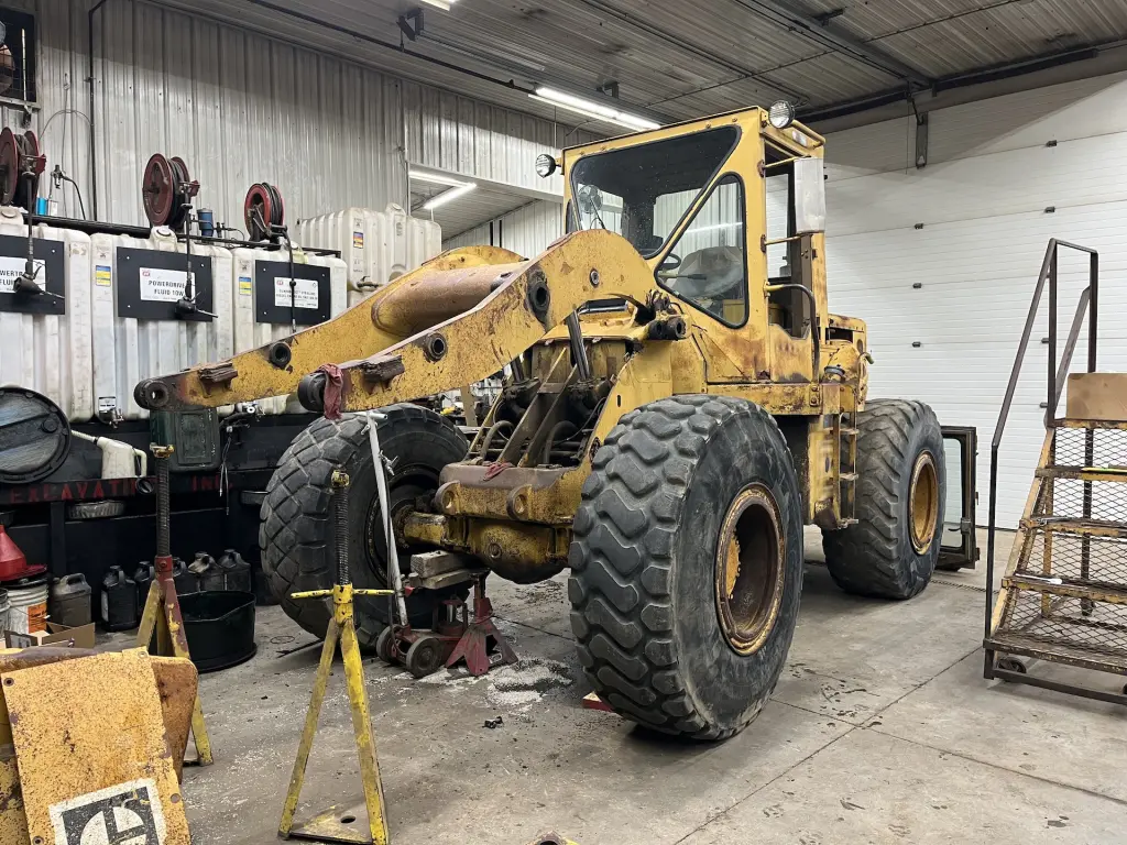

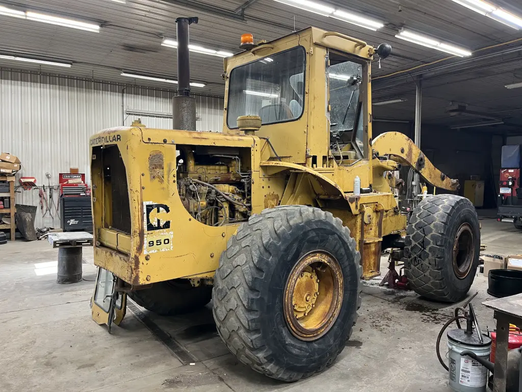

I've posted this loader before on the forum. Today we are finally starting the restoration. Long story short, my grandpa bought this loader brand new in 1979 when he started our business. It has had one repaint, one engine rebuild at 24,000 hours, and has 18,143 hours since then. As far as I know the rest of the drive train has not been touched. I want the loader to be finished in time for its 50th birthday, and the company's 50th anniversary.
Here it is after I gave it an initial steam clean. The plan is to start disassembling and start sending stuff off for repair. I have started gathering some parts, but I am still on the look out for a bunch more.

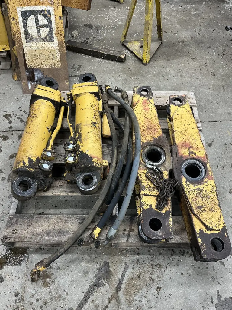

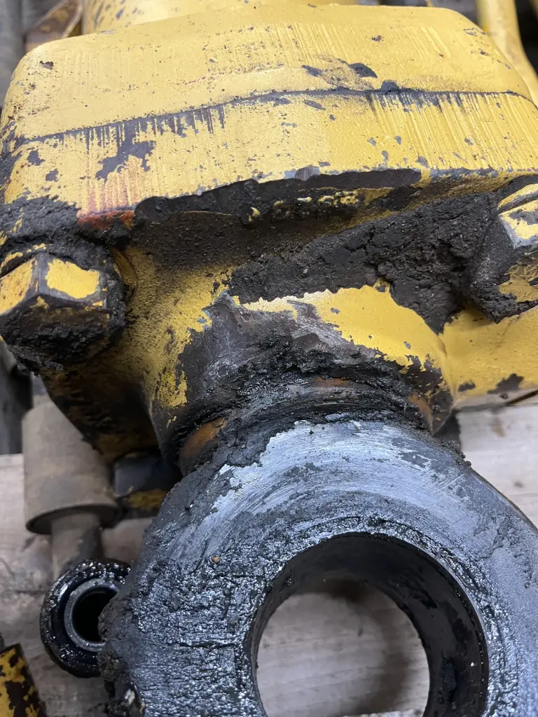

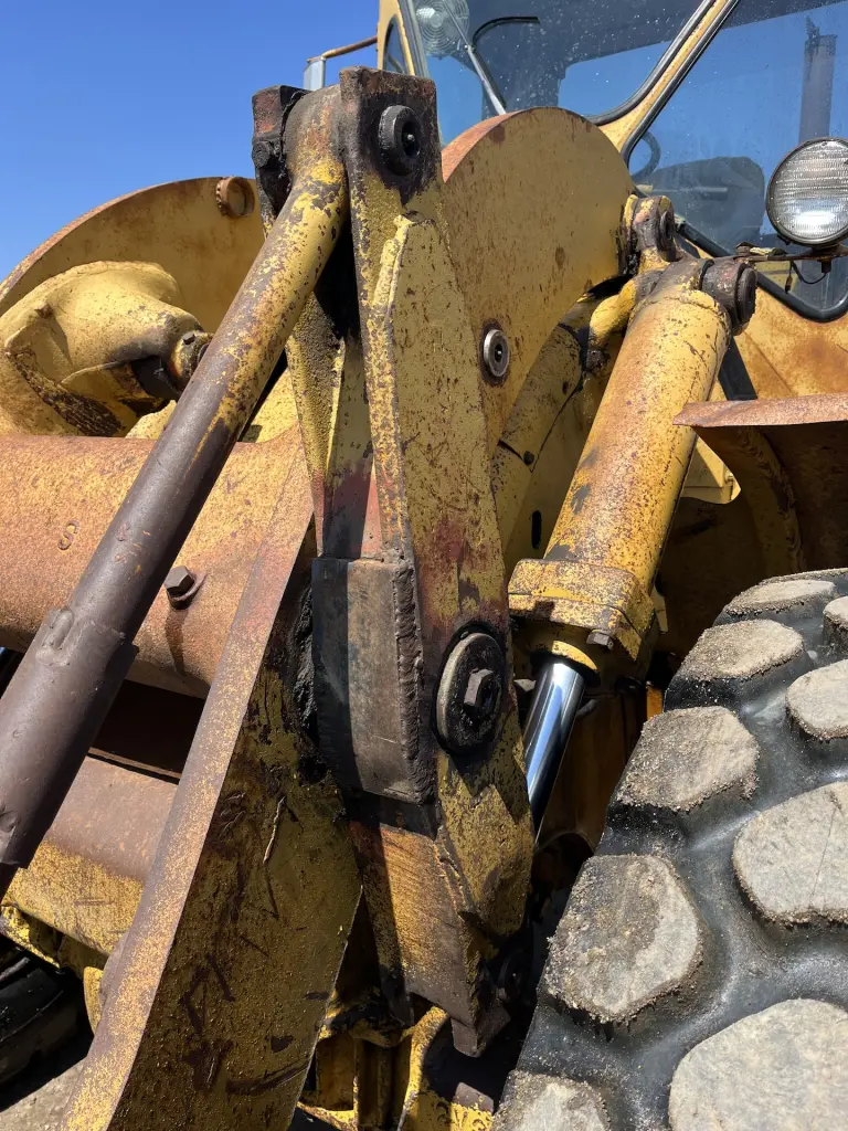

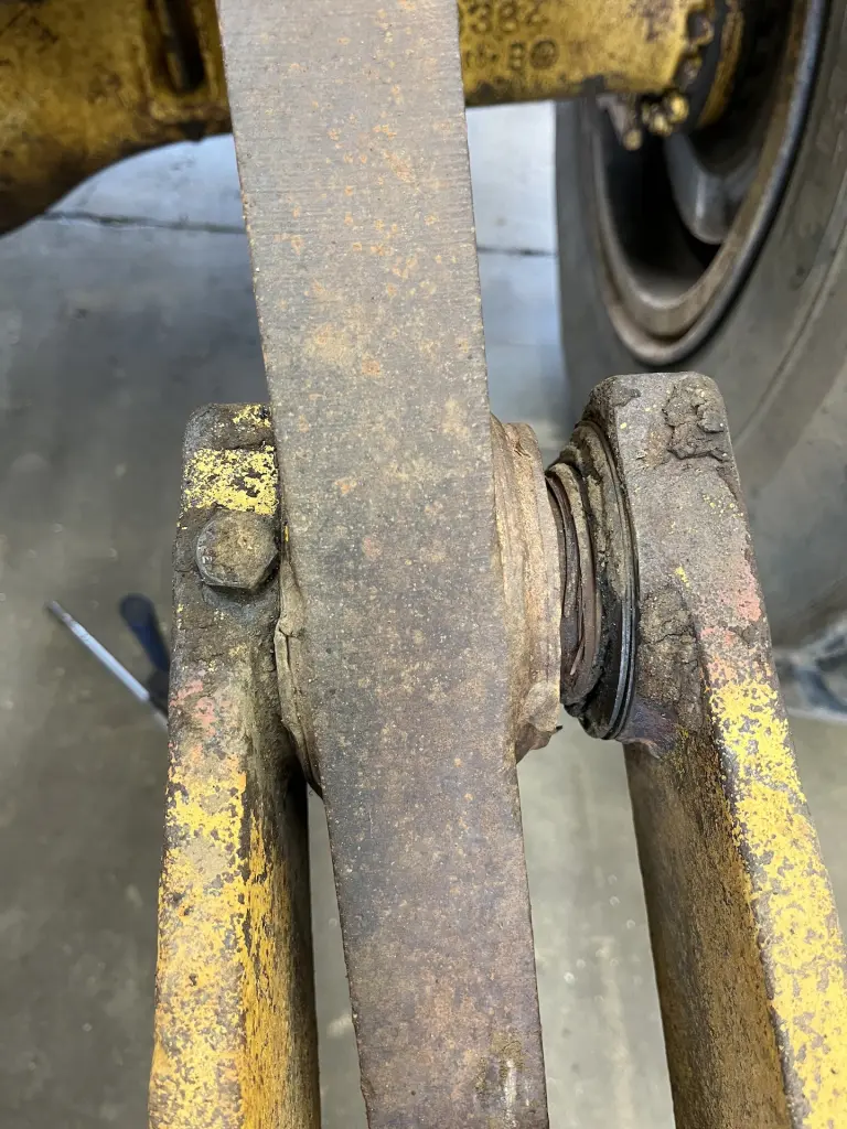

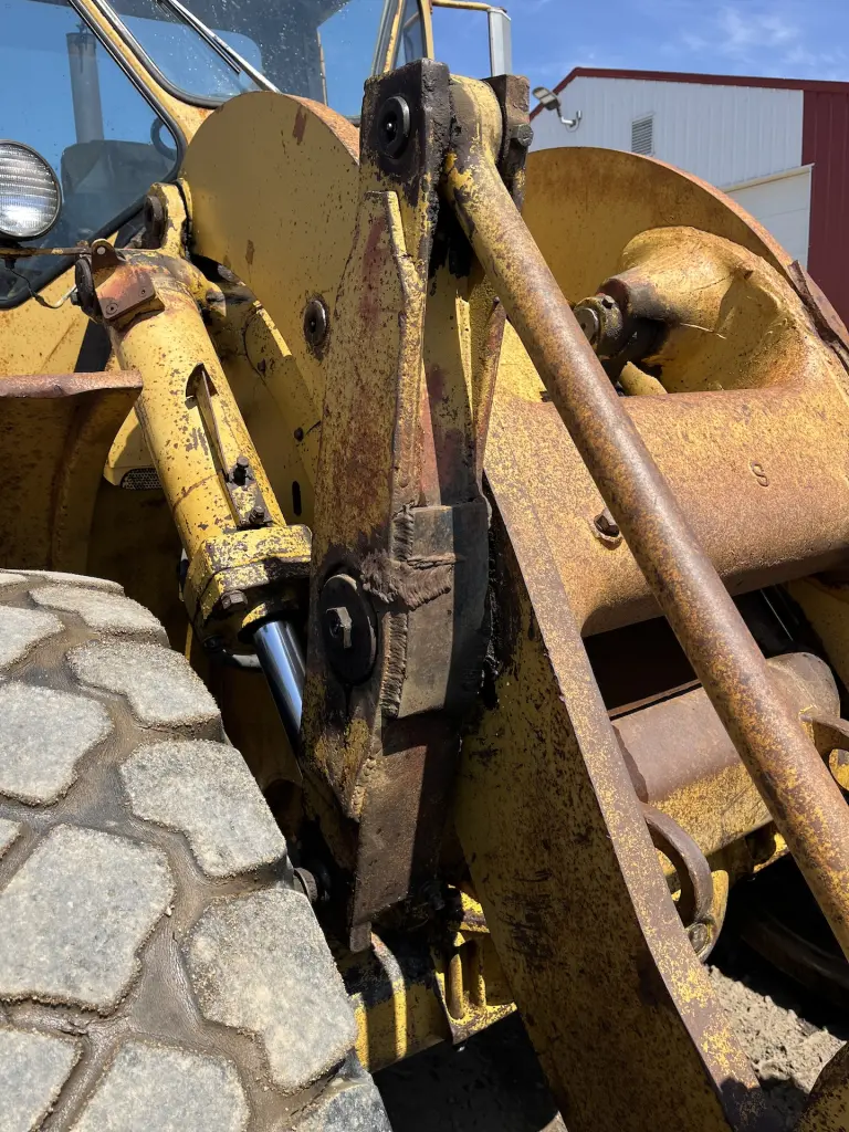

I made a little progress on disassembly. I got the bucket off, and some of the bucket linkage apart and on a pallet. You can see the bushings were worked out of the loader arms and really caused some damage.

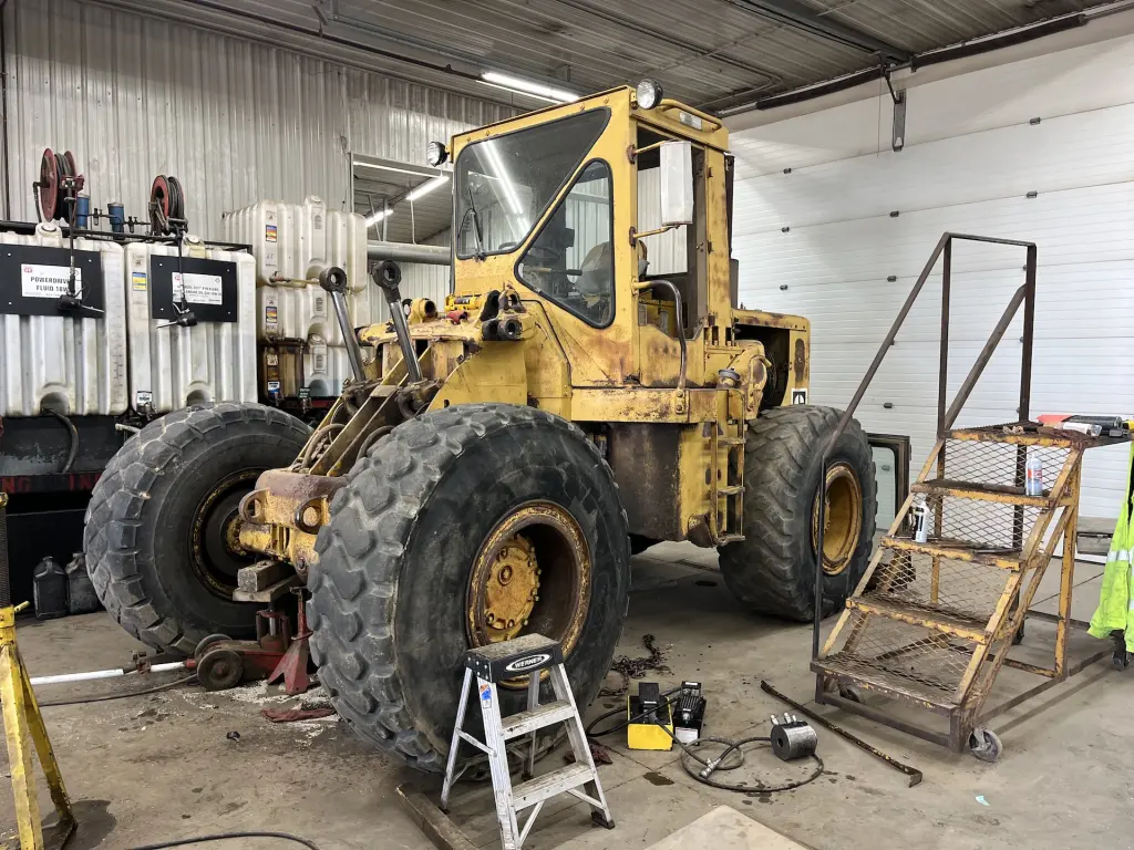

Some more disassembly. Tilt cylinders are about ready to come off. Looks like some original paint hiding under the front fenders. Also found a previous repair on the front axle that will need some attention.

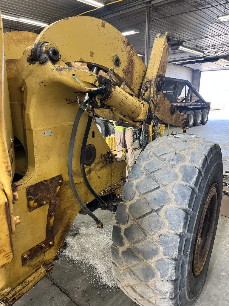

More disassembly. Pulled the doors off the cab, and the rails and mirror off the right side. Also got the tilt cylinders, and the remaining levers off. I'm guessing these heads on the tilt cylinders are both going to be junk.

A good machine shop would build them up and machine seal recess back out to spec sizes, checking to bore for damage would be first to check, then the outside damage.

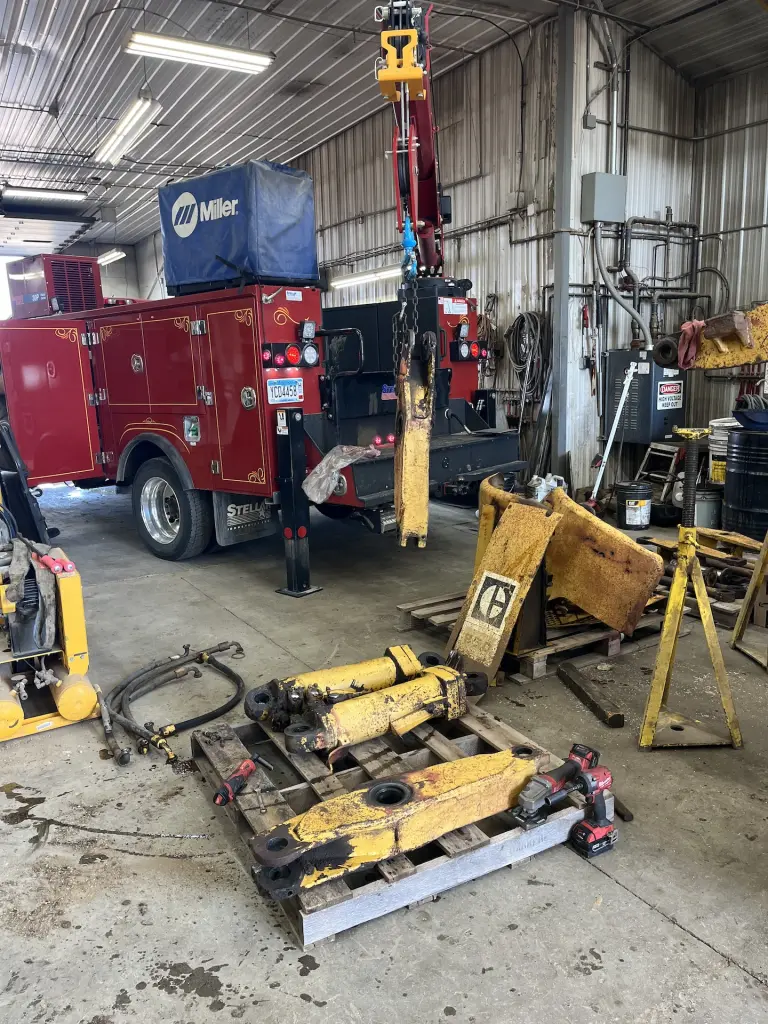

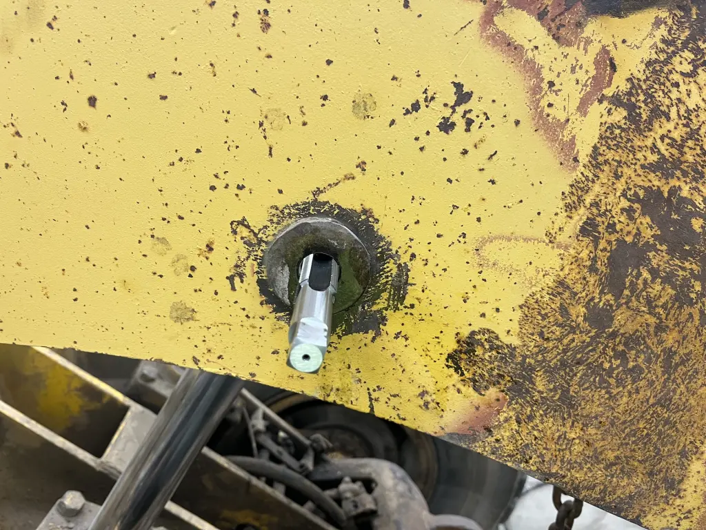

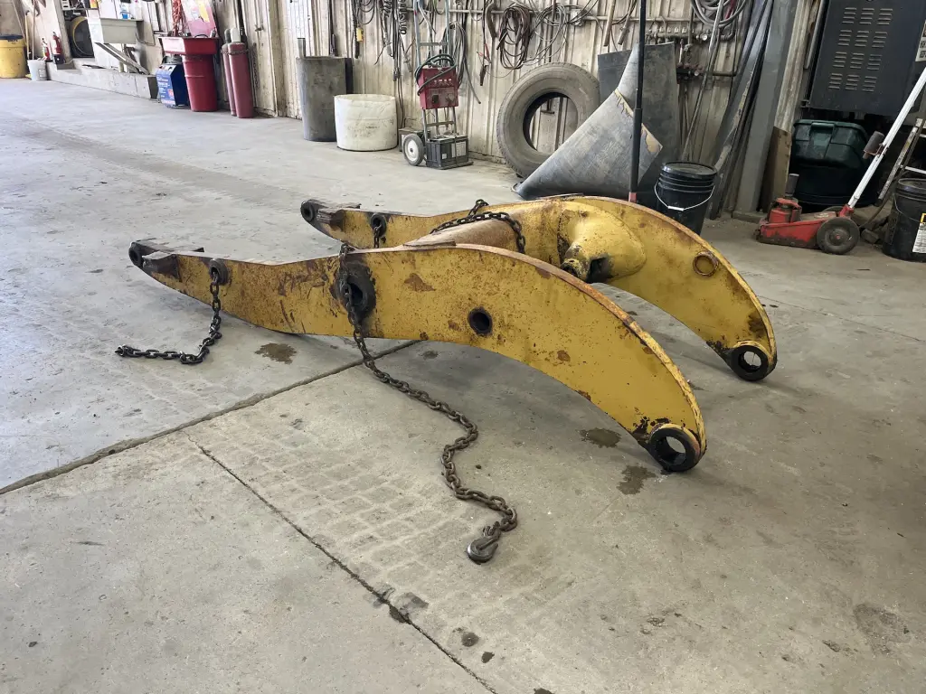

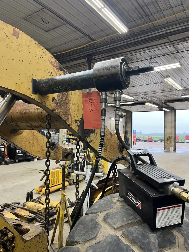

It's been a little bit but I have an update. I had to get some tooling from Ziegler Cat, which they were nice enough to let me use, to remove the lift cylinder pins. These would not budge at all, so I looked up what I needed on SIS. The pins were also mushroomed badly on the outside, so then I had to order a 1" x 14 tap from Cat to get the rod to thread in. But the arms are now off. We used the Cat 926M that we keep around the shop to lift the arms off the old 950. Its funny the size difference between the two loaders.
