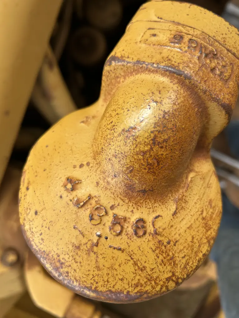

There are 4pm these “brackets” under there. I will get some better pictures.
I have been looking for the seal kits a little and have not had any luck. My cylinders have 4J3569 on them. I have found the seal kit part number 7X2664. But this Fits Cylinder Numbers: 5J8172, 5J8173. I suspect that since mine was made in Japan that the cylinders have different part numbers than the models made in the US. I am going to measure them and see if I can make any progress that way.
Having the Japanese made dozer is proving to make things a little more challenging.

Hi, Jprice1101.
I found when I was working on a ranch in CA. that I had to ask the parts people to look under "Classic Caterpillar" for parts for some of the older machines. Apparently the front line parts lists only go back so far. Hope this helps.
Thu, Dec 25, 2025 11:02 AM
Posts: 16,735
Thank you received: 32
Original cylinder group for that machine would be 4J3456.
Thu, Dec 25, 2025 5:55 PM
