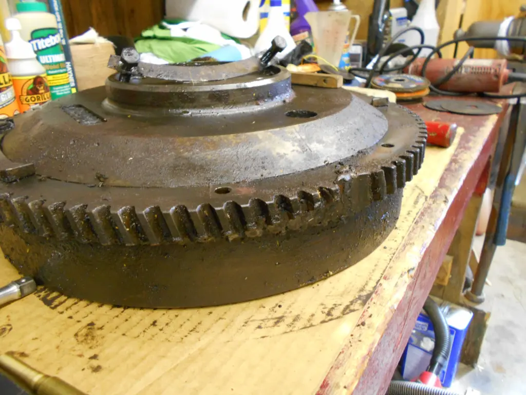

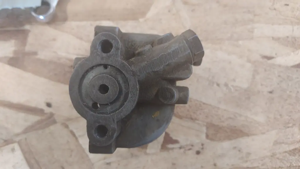

I successfully pulled the flywheel out the clutch access hole!!!! You would not believe how tight that was, unbelievable. Had to pull the starter pinion, lift the starter motor up. the space the pinion remove gave was just enough to cock the flywheel out with a little bar action. The clunk was missing teeth on the ring gear. How does someone do that? See picture. now I need a ring gear which seems hard to find. The confirmed part no of the ring and book is 7B6248.

forgot picture. [attachment=73791]DSCN0376.JPG[/attachment]

YOWSA![img]/media/kunena/emoticons/shocked.png[/img]  I see now. Grind me a pound.    Yeah they're a little tricky to maneuver. But lighter than others.

That's that under your skin grinding racket when owners are too damn lazy to fix the brake and pinion!
General Gear had a new one for my 5U, had to finesse the bolt holes a little but otherwise bolted right up
