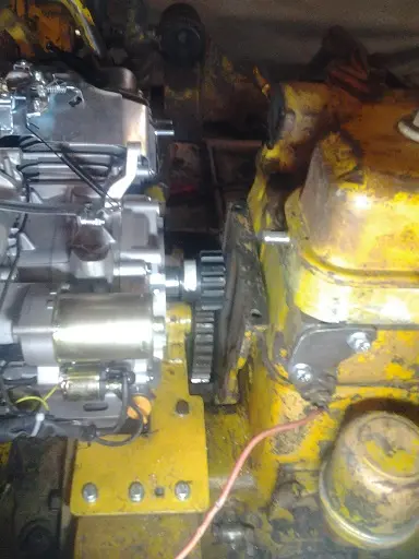

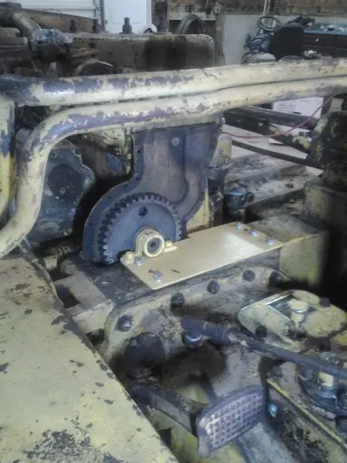

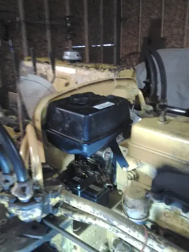

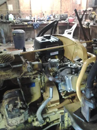

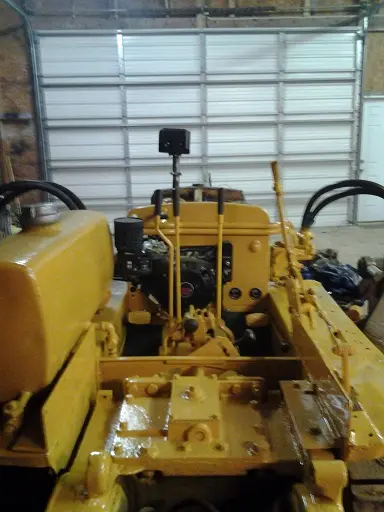

I recently posted this conversion on the Heavy Equipment Forum and was told that the people at ACMOC would be interested in it. This is my version of getting rid of a bad pony motor. My son brought the D2 to my place about 12 years ago with frozen steering clutches. We replaced the steering clutches but could never get the pony motor to run without it flooding. My son moved and it was sitting ever since. I decided to see if I could get it running, which I did and 30 seconds later the pony threw a rod. I did my research a came up with three options, used pony motor(hard to find), convert to electric start(expensive), or put on a different gas engine(couldn't find anyone that did it). I decided to try the gas engine. Here is the process was as follows, I purchased a 13hp electric start engine and battery from Harbor Freight($350), a gear similar in size to the one on pony for 1in shaft on Ebay($35), reused the back cover, 40 tooth gear and shaft from pony, made a plate to cover water and hold a carrier for the gear shaft, put the motor in place to mark mounting holes and see what would need to be moved, removed the motor, drilled and taped the mounting holes, raised the hydraulic blocks on fenders 1in to clear the new motors valve cover, remounted motor and made spacers as needed, made a plate for the water port on diesel engine, mounted fuel tank on back side of dash and enlarged the filler hole, modified air cleaner to fit, cut down the exhaust pipe and welded it so it would run from new engine back to intake manifold, cut down the tail pipe and mounted muffler( new motor needed more back pressure), ( due to lack of space for the monster air cleaner) I ran a throttle rod threw the dash and installed a air cleaner right on the intake manifold and built guarding with lubrication points for the gears. To me it sounds easy now but with no were to start it took a lot of trial, error and fabrication. It now starts pretty much starts as it always did. I am attaching so pictures of the process.
I also have pony motor parts for sale.[attachment=34006]first set in place.jpg[/attachment][attachment=34007]gear mount.jpg[/attachment][attachment=34008]Motor to gear.jpg[/attachment][attachment=34009]fuel tank.jpg[/attachment][attachment=34010]modified exhaust and throttle.jpg[/attachment][attachment=34011]final view.jpg[/attachment]

Wow, that is really a great project. You must have created a complete sealed compartment for the gears?
Thank you so much for taking the time to post this especially with the great explanation.

Sad part is, you made it look too easy! Thanks for sharing! Don't worry about originality if it gets the job done for you instead of sitting broke down!

nice job looks clean. did you have to do much adjustment of the pinon latch or dose you out put RPM match the old motor with the new gearing. i will say it would be nice to have a recoil some days on my one pony lol

I did have to adjust the tension springs bit I don't know if it was because of the new motor. It wouldn't stay engaged with the old pony motor. It does work fine now.
