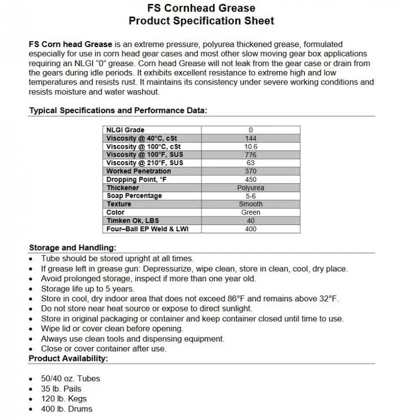

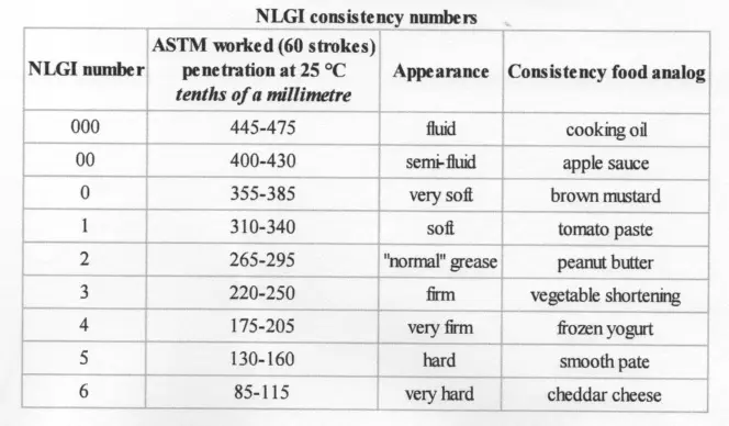

Now, the fact that 80/98W just leaks out so fast may also explain why the oil that came out was not even just old 80/90W oil, but, he says, something like CornHead grease, 0, 00, or 000 grease. His best guess is 000 grease. He says, in fact, that he had to heat up the lubricant just to get the water to separate, as the oil/grease would not float on the water; the water was just pooling up in pockets within the lubricant.
So this is question #2: what type of lubricant is this likely to be, and what is a good source? At this point, I cannot tell if the guy who sold it to me put that grease in there just to avoid having any leaks that would prevent a sale or if the hazel nut farmer that used it from when it was new until it was sold to the guy that sold it to me had already being using it with this super high-viscosity lubricant.

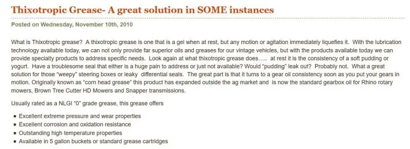

Nothing wrong with using NLGI "0" (corn head grease). Just the thing for leaky seals and can be continued use if that solves the leakage problem. I think he's reading the grease scale backwards, more "0's" means thinner. Do not go heavier as it will lead to channeling and no flow.

Thank you. We find that even with grease in there, it leaks while working/warm and stops leaking when the tranny cools down after we shut it down. The neighbor who pulled the grease out says that he has a bucket of corn head grease, and he says 1) what came out is definitely thinner and 2) corn head grease would be too thick. Most of what came out can go back in anyway, but we have to add about 5 gallons, so he wants to try 0 or 00; won't know how it compares to what came out until we get a bucket.
But it sounds like we are kinda on the right track.
Thank you for weighing in!

i used to make a mixture of grease and gear oil called Knuckle Butter. used it in the enclosed steering knuckles on 4wd trucks etc when the seals wouldn't hold oil any longer. now i use corn head grease because it flows better and stays put better also.
