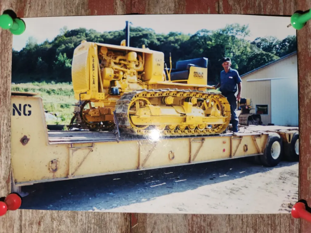

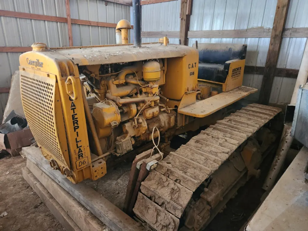

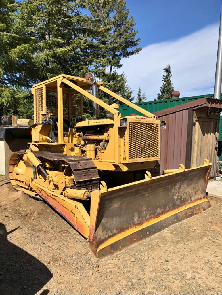

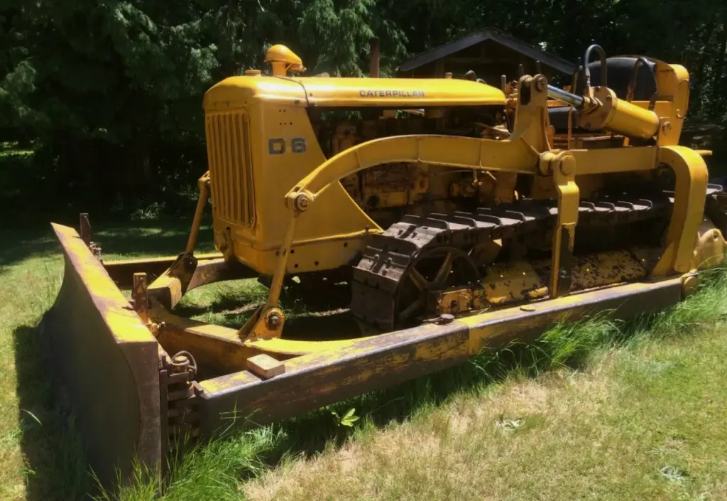

Hello!  I recently acquired my grandpa's 1940 D6 that he had restored about 20 years ago. He passed away a few years ago and I was able to purchase the 1940 D6 before the shop and the rest of equipment was liquidated. It was his pride and joy and I was determined to keep it in our family. I grew up riding CATs with my grandpa and dad with their small construction business. The D6 has been setting for about 10 years, untouched in a shed. I am looking for some advice on getting it up and running again. Here are the specs:
1940 D6
Serial: 2H8320W
Inline 3
I've got the parts catalog and the operator's manual (waiting for shipping) and I already pulled the pony motor carb and got the Zenith carb kit to rebuilt it and the Spark plugs. I don't have a grease gun and fitting that fits, but see it's a part number 50303 in the parts catalog.
What are some things I should and or need to accomplish before trying to start it and get it running again?

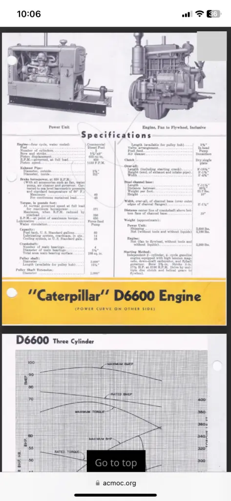

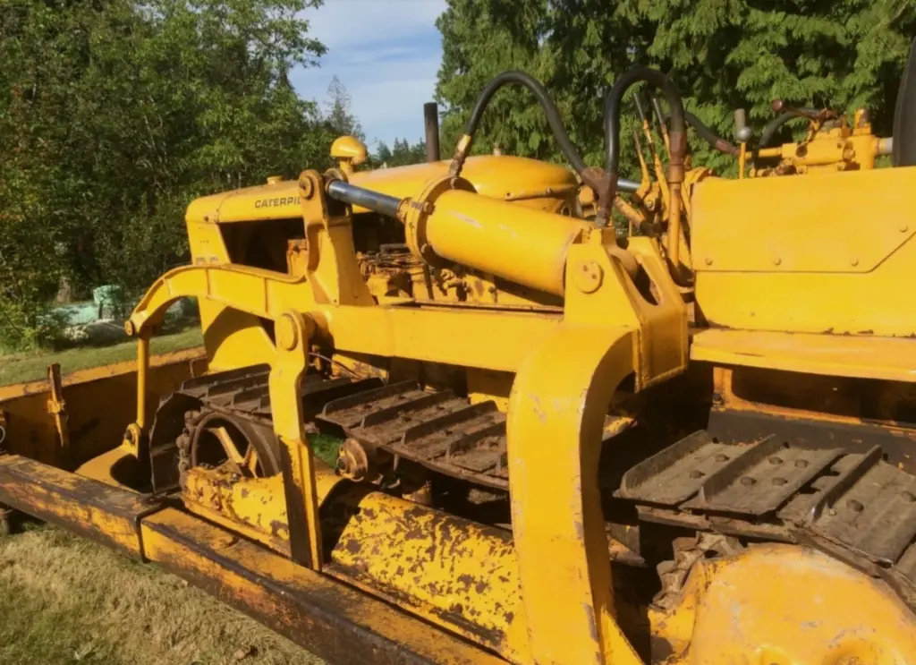

Hi I have a D6 2H8692W 1940 as well, it’s actually a 3 cylinder D6600. Here’s a little info on it.
Sat, May 4, 2024 10:12 AM
clayton
Posts: 221
 [attachment=76278]IMG_0998.png[/attachment] [attachment=76278]IMG_0998.png[/attachment]
