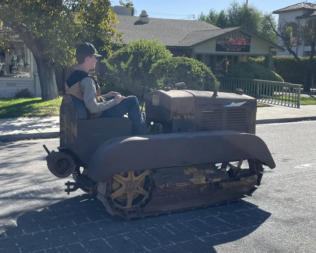

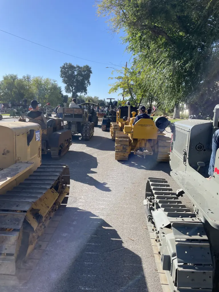

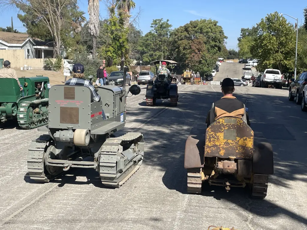

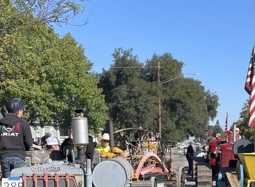

We always enjoy the pioneer day parade in Paso! Not many places you can drive your Cat though town. I will post some pictures. Skinner
