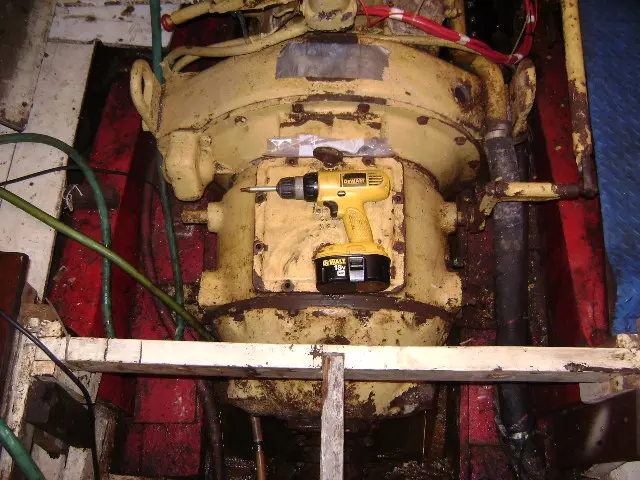

Of course nothing could be that good or simple, I’ve now got a problem with the clutch....
The old Joe’s gearbox has got her self into forward gear and won’t come out....
A new problem......!!!
[attachment=9242]DSC02759.JPG[/attachment]
You’re not familiar with the old Joe’s gearbox circa 1940 I suppose.... ???
Glad to hear you got it done!!!! That's a tight fit and why I was asking where the starter was mounted. If the solenoid continues to give you a problem there are units available with upgraded heavy duty contacts. Looks good and like it belongs.
Sorry, I don't recognize that transmission but if it is multispeed there may be shift rails with lockout mechanism that only allows engagement when clutch is in neutral. If the rails and detents get worn it will sometimes allow two gears to engage at once which locks it up. Usually means adjustment or removing a cover plate or shift tower to pry bar them back where they belong. That transmission seems unusual for a marine application which is usually forward or reverse and maybe a second speed.
