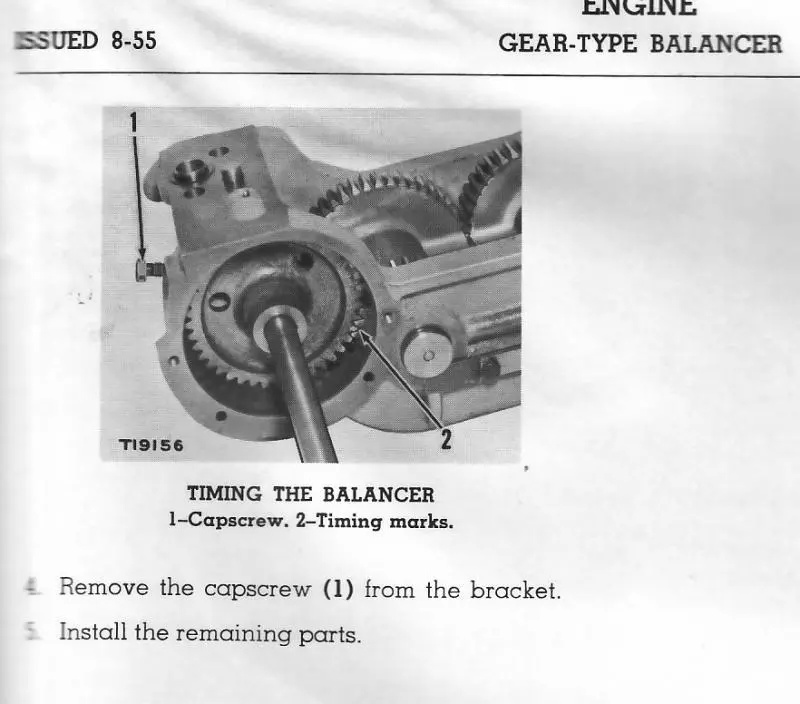

You need to take down the front section of the oil pan. Then you can remove the front support for the shaft and then take down the pump and ballancer unit. The pump and ballancer section is HEAVY. Take it all apart and look for anything that might have jammed up the gears and broke the shaft. Going together mount the pump and leave the drive gear and shaft hanging. Set the ballencer weights at bottom and lock with a bolt. There is a hole for this. Then put any cyl on TDC. Should be marks on flywheel under square cover. Then put support up meshing the drive gears and remove the lock bolt. The ballencer weights must be timed together and they turn at twice crankshaft speed. Everytime a pair of pistons are at tdc the both weights are at bottom.
