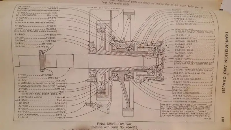

Talked to seiscat today he told me where to look in my book and think we came to the conclusion that to remove i need to pull off the dead shaft 5m5032 to the sprocket and to install push off the dead shaft to the sprocket just wanting to double check because im aware of the pressure that it will take to remove and install and dont want to damage the final case. That being said yes i know there is a puller and a press i have looked into hiring it out and it is far out of my budget my book is a reprint if anyone has a good picture of 8m9003 pulling sleeve or 8m9013 and 8m9010 or any other productive advice that has been through this please share.... if i need to pull or push off sprocket shaft/hub 5m5037 please let me know if im reading it wrong...... p.s. thanks for the help today seiscat and appreciate all the other knowledge that I have gained from this site this is a great club to be a member of

Thanks wombat I do have a service manual and I attached a copy of the page that relates to this. I agree it looks like a big bottle jack and I'm lucky enough to have a lot of really heavy material to make things with and a 465amp welder 😊.. I just am trying to double check the correct place to apply pressure not to tear up my machine the correct depth in installation is .25 inches shy of the spines when pressing the sprocket on I do wish someone had correct puller/press to help me but maccallister cat in indy gave me an estimate of $2600-$4000 just to come press and pull a sprocket and that is unacceptable to me.

seiscat
Posts: 1,319
Yes, as Ray wrote, I had a couple of adapters made up for the D2 but I only had to get up to about 15t to pop them off. Even at that load, I hid behind the other side of the tractor to work the pump : )
The pic is from the D7E Service Manual. To remove the sprocket the ram pushes against the retaining nut which has been loosened @ 1/4" from the sprocket. To install the ram pushes against the 8M9013 adapter which is screwed onto the dead axle.
[attachment=56250]D7E sprocket press.jpg[/attachment]
There should be an independent shop in your area that has the press equipment and will do the job for less than what your dealer quoted.
