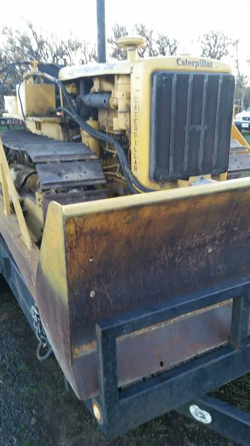

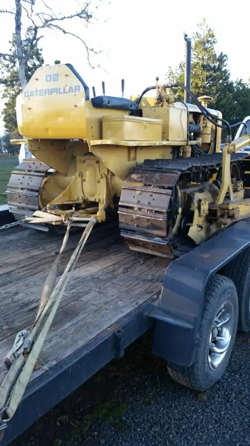

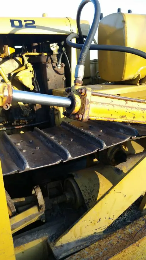

Been in the hunt for a dozer/crawler on a somewhat light budget of $7k or less, and have been doing a lot of research and basically believe I could easily be getting into a POS or a gem, haha. After losing on a few auctions and getting uneasy answers to questions from a few pasture sellers, I have come across a CAT 42' D2 5J, owner asking $7500. Described as "it runs and operates very well and has a very clean dozer blade."
It looks very well maintained and very clean for its age. Is the price probably where it should be given the limited info I've provided, assuming everything is in "as good as it should be working order"?
I am a general contractor in the PNW, mainly doing residential remodeling/new construction work, but I have found myself a few times needing equipment to do flat work, move some dirt, driveway, spread some 5/8" gravel, etc... and I have 3 acres of property needing some work done. I am basically wanting something where we can putt around and knock out the small stuff on easy sandy silt soil, flat terrain, no trees or stumps, when it doesn't warrant calling in the big boys.
Previously was looking at 70's era Case 450s which are kinda hard to acquire in my price range without risk of undercarriage rehab being not too far away. Ironically our dump truck for delivering materials will be a 51' Chevy 6400, haha! Appreciate feedback, this site has been a wealth of knowledge as I've deep dived old posts.[attachment=47844]D25J-003.jpg[/attachment][attachment=47845]D25J-002.jpg[/attachment][attachment=47846]D25J-001.jpg[/attachment]

I wouldn't consider a D2 as a good tractor for a Contractor (small or large) to be making money with.
Operating a blade on it for general grading is a skill that often needs practice to get good at and stay good at.
I'd be looking at a CAT D3 or 350/450 class John Deere as a Contractor you need a PAT blade to make money!

unless it has the larger front idlers it will tend to rock a lot and be more difficult to grade with. Price seems a bit high to me as i only paid $3500 for my 1957 4U

I have used my 5j on various jobs clearing brush, pushing hog fuel and cleaning out barn stalls,and pushing dirt. I would stay away from a d2 if you need to do any kind of finish grading. If you can find a long frame with the big front idler it would be ok. If you have the dump truck already get a d4, much better machine for what your trying to do.
I have bought and sold a few d2 bulldozers and probably wouldn't pay $7500 for that one. It looks clean and probably is in good shape but there are plenty of them around and pretty easy to repair and maintain

Good info, thanks everyone. So sounds like at least a D4 class is the best bang for buck to accomplish grade work at a minimum then. I've seen two of those as well in area for sale, a 46' D4 for $2750 in "good working order" and a 7U D4 for $4500 which owner has barn stored for last 30 years which is "in good shape, runs strong", which is appealing since they've had possession of it for 30 years, makes you think they likely know that beast up and down and every qwirk it throws, so probably took good care of it.
Is a D4 getting closer to what I'm looking to do, would I grow to form a palpable relationship for occasional grade work?! Haha, this is just a beginning setup, so I'm not looking to break time records nor start out with biggest and baddest, just need some direction that the rig can make it work, and these two D4s are in that price range if the CATs are up to the tasks.
-edit: I should add that the cheaper one has been outside stored it appears and has the addition of a pony motor, so the other one I'd assume is likely less likely to see maybe water in tanks, etc, having been barn kept during non-usage. These are both Oregon located D4's, so anything kept outside around here is seeing water!

i would say in my area that's too much. 2500-5000 is the rage i think for a good running. as said the 5j has small idlers and was never design to have a blade hang off the front of it. that being said it's be done lost.
