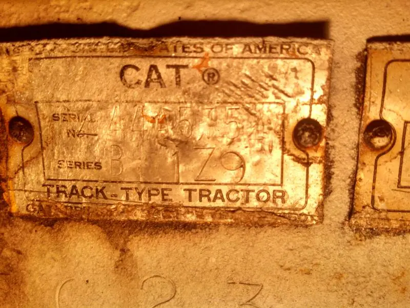

Well, after haveing two Dw6's for several years now i have finally decided to proceed with the restoration one of them.
I have started with the D6B 44A5751 model, i purchased this one along with a D69U Dw6 from a friend that runs a scrap yard in VA.

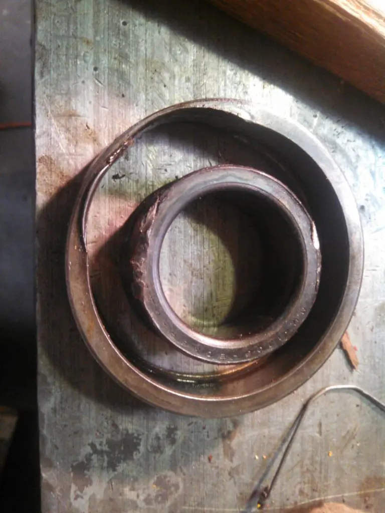

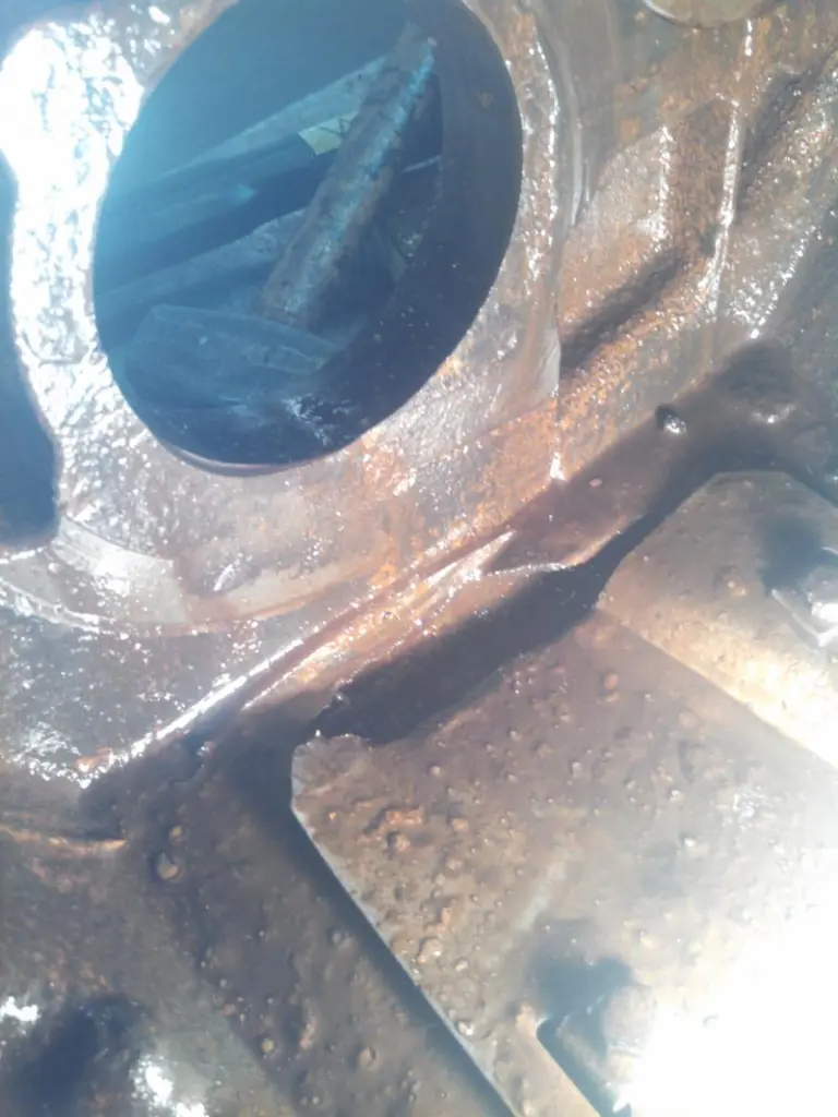

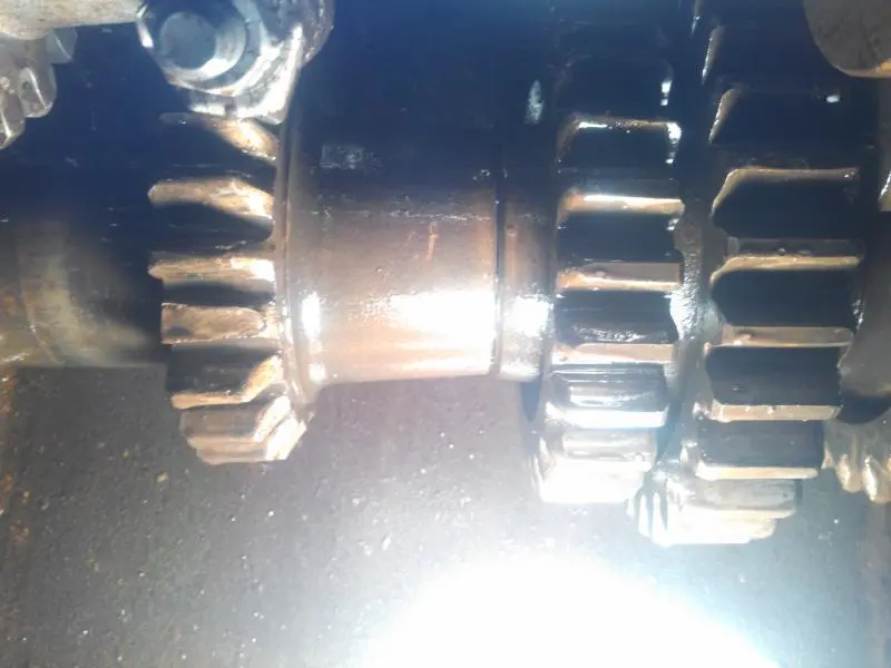

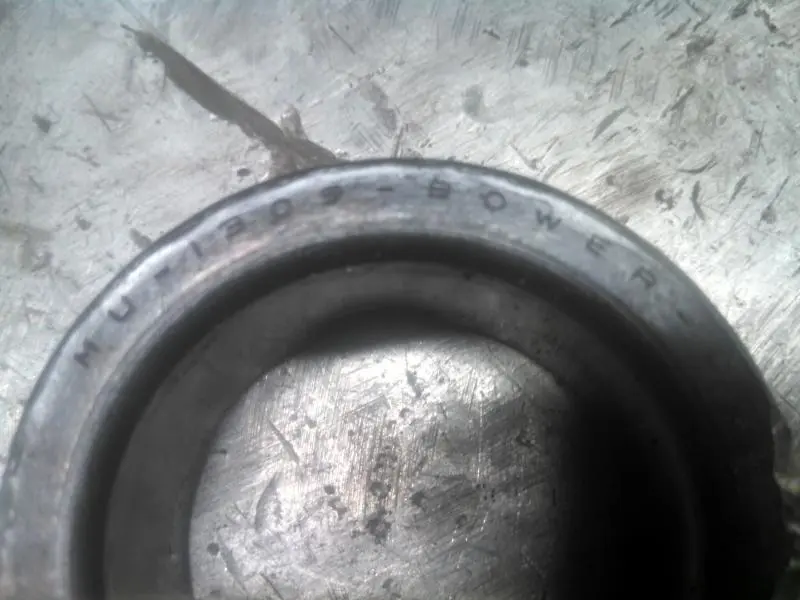

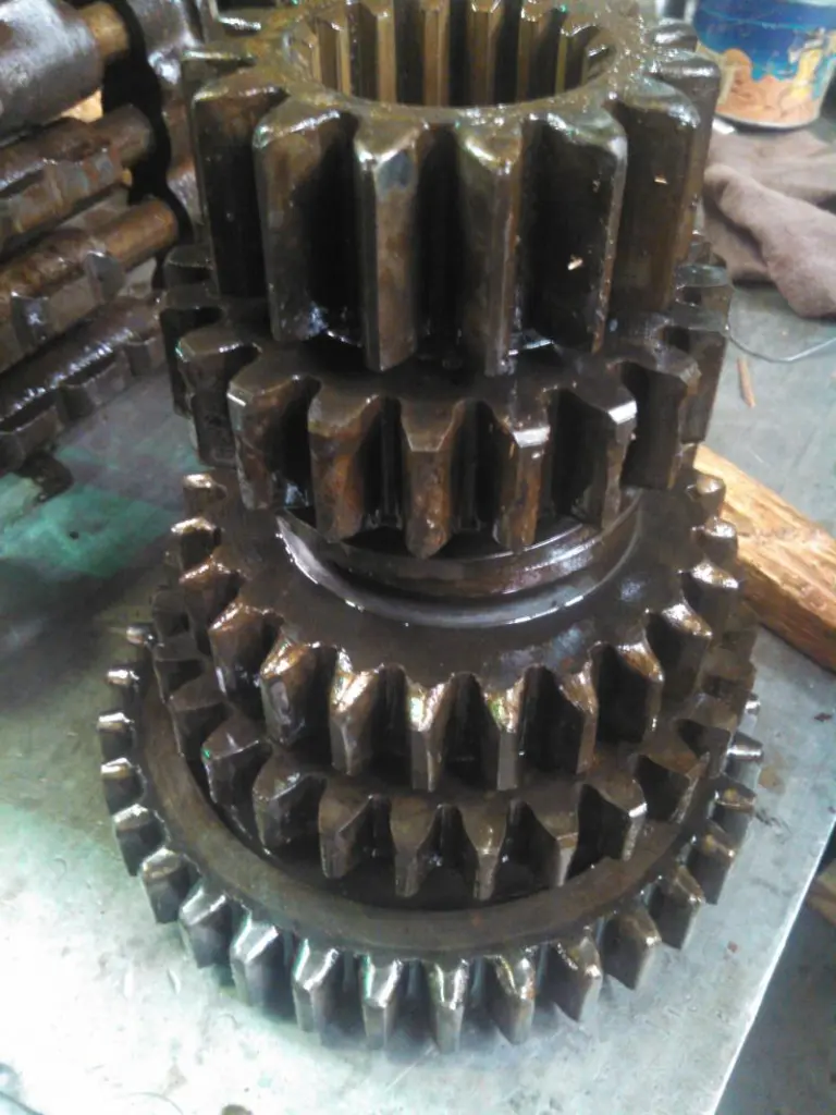

Now on to the transmission issue, after inspection we discovered the bearing in one of the gear shafts was gone....long gone (as you can see in the pics).

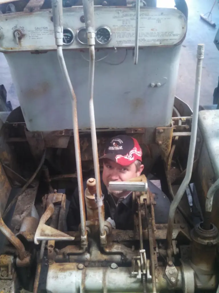

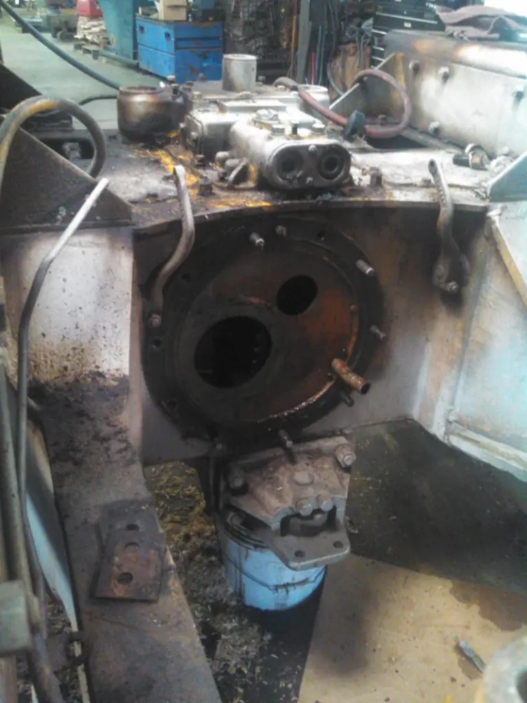

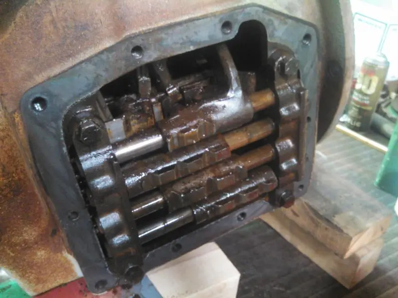

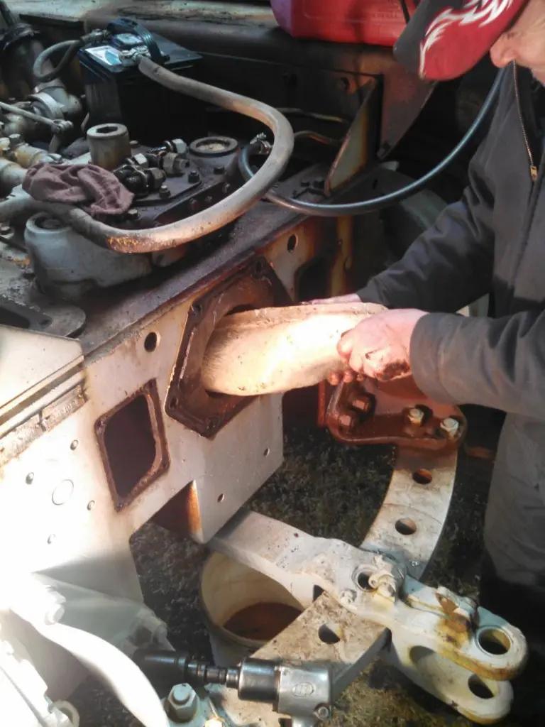

So yesterday i along with my good friend Jerry (who really gets into his work, see pic) help me take the trans out and got it apart only to discover that once the bearing failed it also took out some teeth on a few gears.
One good thing about it being 4 deg out was it was easy to see if water was leaking into the rear end....yes that is a big chunk of ice being removed.

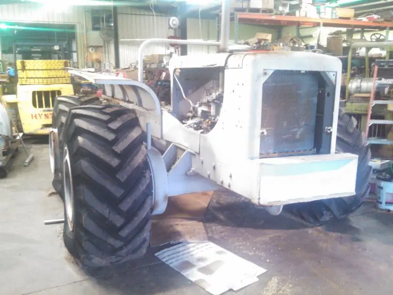

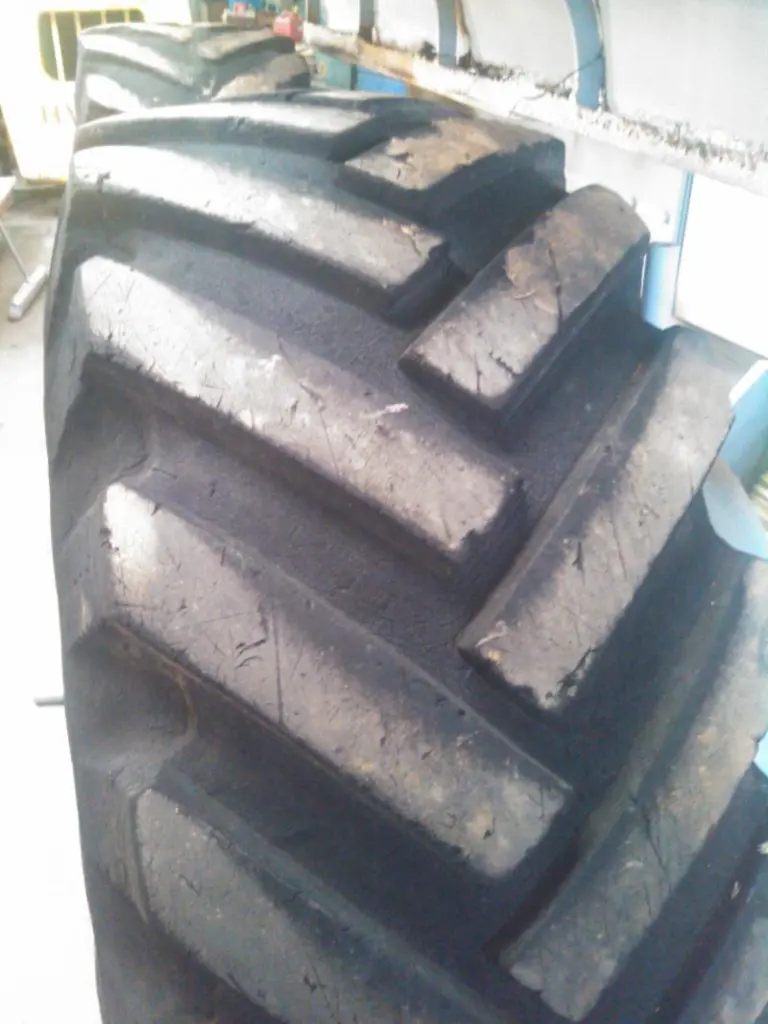

Something i would like to know from other DW6 owners is the tire size, this one has 23.5x25's

Looks like Jerry's havin Subway! lol

Yea it was a cold cut special...LOL!

MOG5858 has one he rescued from that floodwater a year or so ago. He should be able to help out with the tire size. Have not heard from him for a couple weeks. Might be super busy at work.

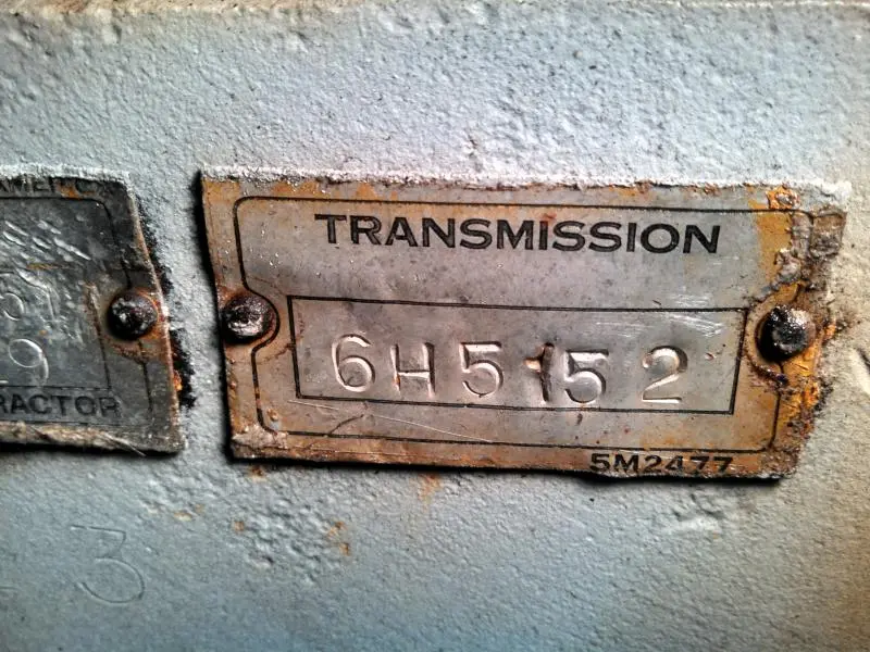

Bull gears and pinions are different in 9u and D6B. Transmissions are different; mainly due to pinion brgs. BUT the gears may be the same; have never checked the gear part numbers.
Mon, Feb 23, 2015 11:17 AM
chriscokid
Posts: 3,341
Reply to Mervyn Pepper:
while i am still searching for the correct parts book does anyone has a scan of the transmission breakdown that they can share as some of the gears that i need do not have part numbers on them. Also if possible a scan of the sterring clutches as i have them removed and would like to see what options i have in parts.
