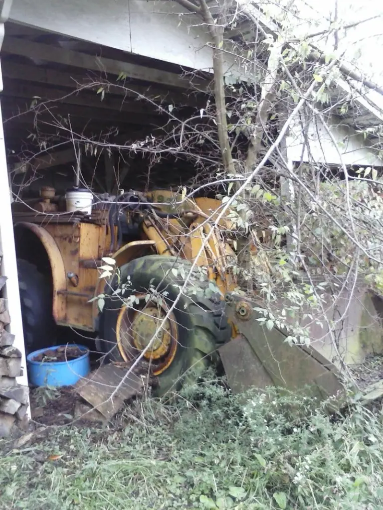

I just got a heads-up on a 922B rubber tire loader, no cab..
I went to take a look see at it this afternoon and to retrieve the serial number and check oil and antifreeze both full . That is a good thing..
The number is 94A2609.
What would be the year , engine , etc ????

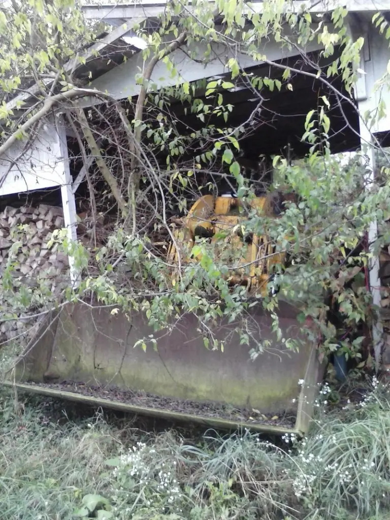

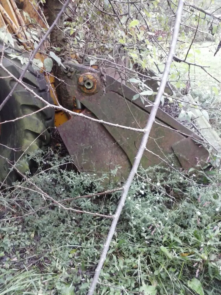

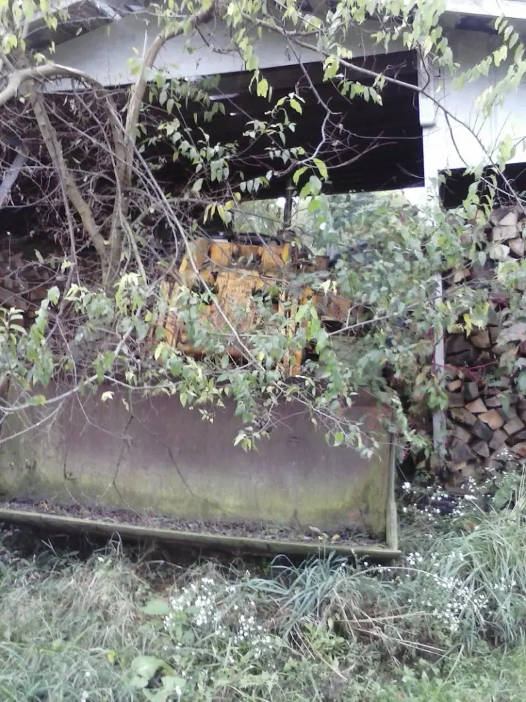

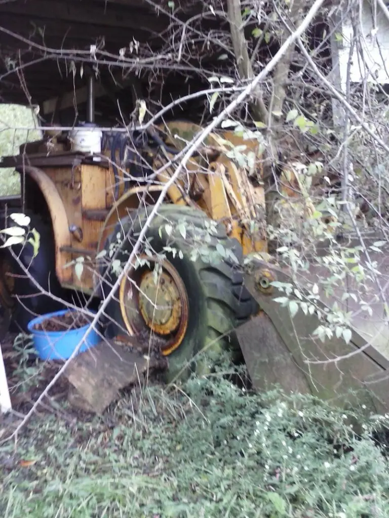

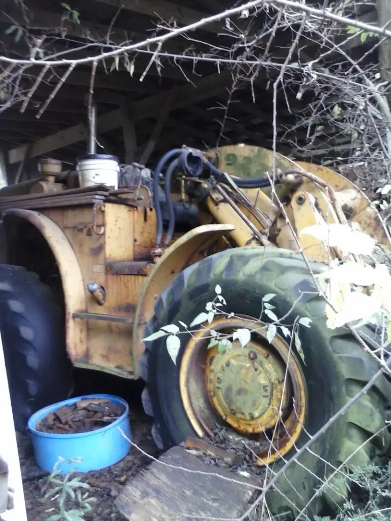

I was told the machine was parked because the power steering quit working. They were using the loader that morning (was very cold that morning) used the machine for about a hour. started it back up and no power steering. That was ten to fifteen years ago. Least it quit in the shed ,and it has been sitting their mostly out of the weather ever since . Here are a few pictures taken with a cell phone , not the best pictures but , the phone is all I had...LOL...[attachment=19997]CAM00582.jpg[/attachment][attachment=20001]CAM00586.jpg[/attachment][attachment=20000]CAM00585.jpg[/attachment][attachment=19999]CAM00584.jpg[/attachment][attachment=19998]CAM00583.jpg[/attachment][attachment=19996]CAM00581.jpg[/attachment]
