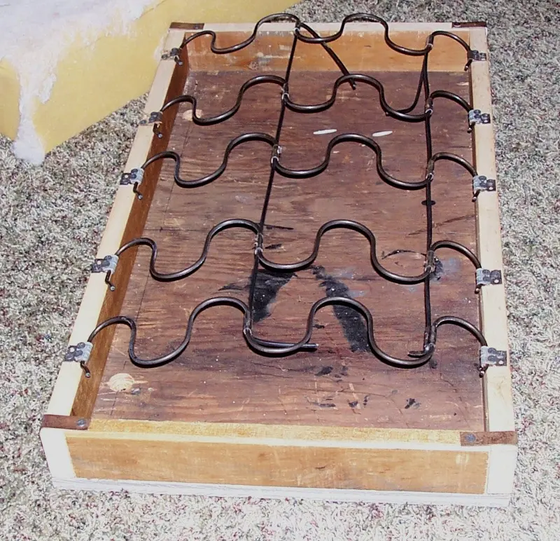

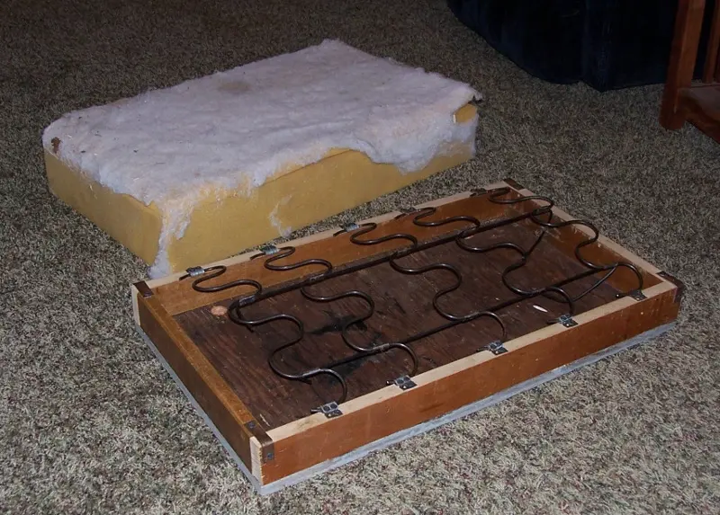

It was messy weather today, so I worked on my new seat cushion.
An earlier visit to the local thrift store's Dumpster yielded a foam cushion and the Z-springs from an easy chair. I broke the wood that held the springs such that the wood came with the springs so I could salvage the mounting clips and reuse them.
The foam was 27" wide so that's how wide I made the seat. The D2 seat sides are about 30-1/2" apart, and while my cushion will leave and inch and a half or so at the sides, it will be much easier to lift out than if it filled the space.
I made a hardwood and plywood base to mount the springs on and cut the springs to fit with their natural upward arch. The plywood bottom is drilled to locate on the two pegs in the D2's seat frame.
[attachment=20755]104_4532.JPG[/attachment][attachment=20756]104_4533.JPG[/attachment] I wanted the springs because even though I am lean, I have "bottomed out" on too many seats to want to do it again. There's no photo, but I covered the springs with some of the fabric from the original chair cushion and stapled it to the top edges between the spring clips. The idea was to protect the foam from the springs.
