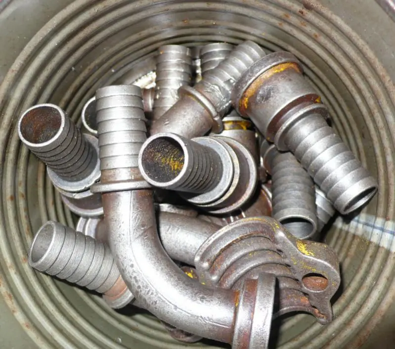

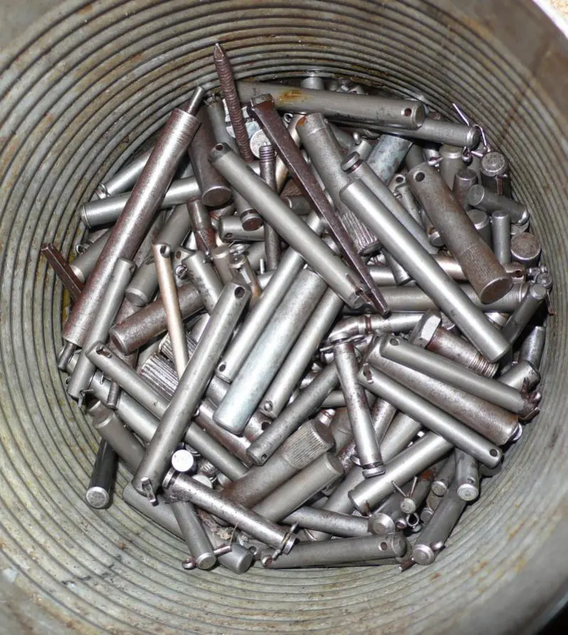

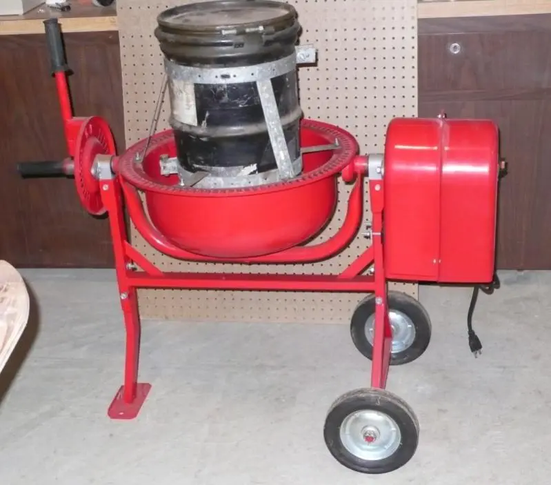

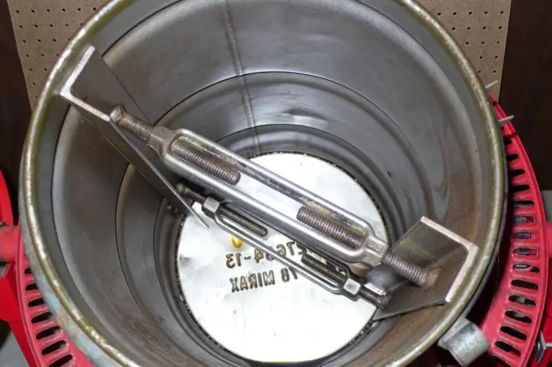

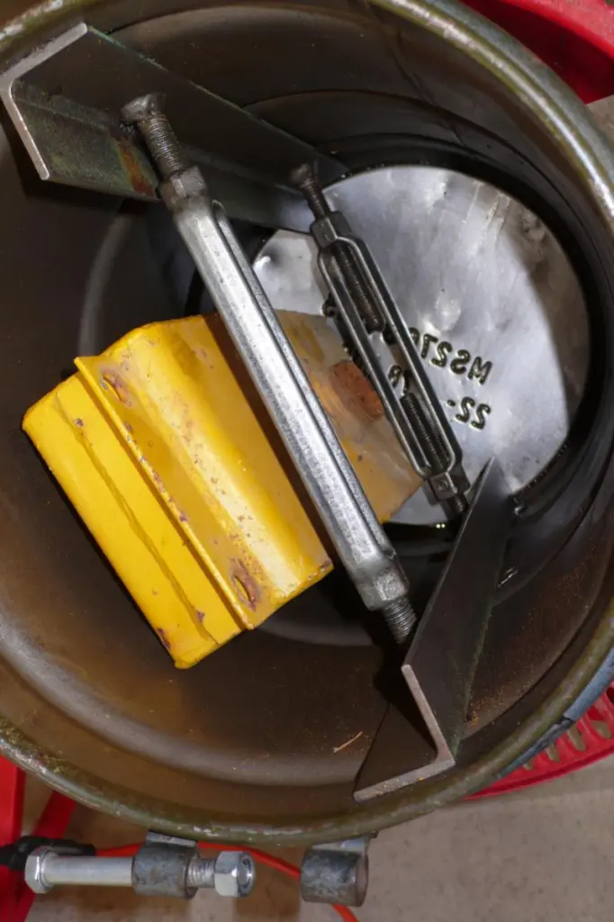

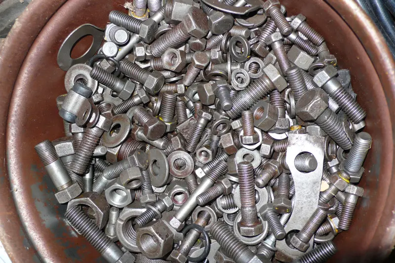

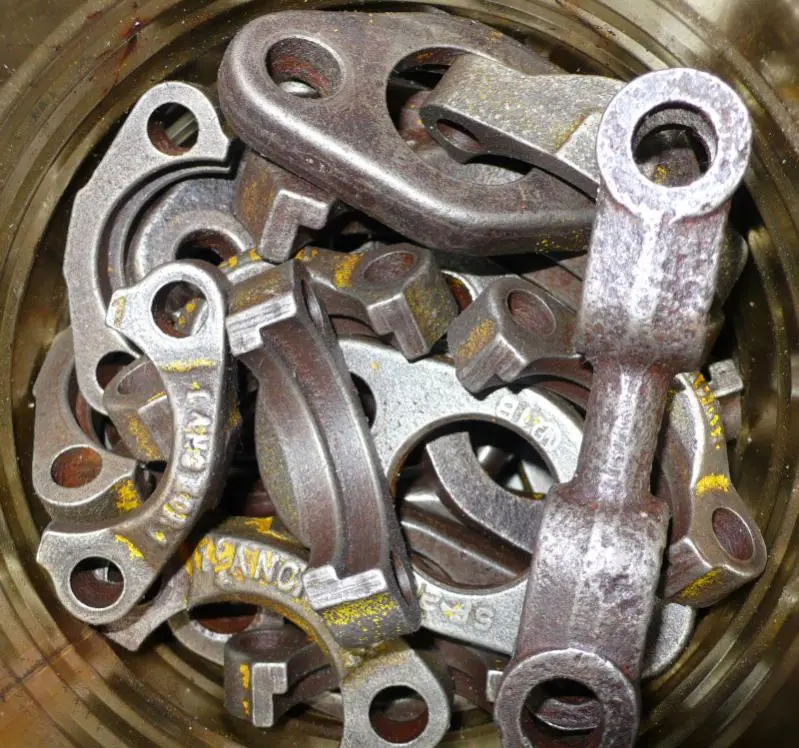

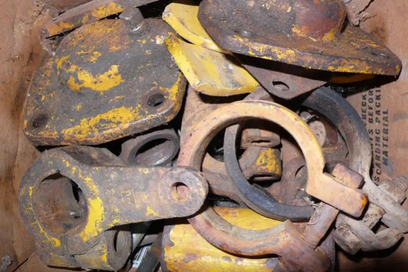

There was a discussion on another board about how to clean fasteners and other small parts, I thought I would share one of my methods of cleaning. Here are some pictures of the parts cleaner I made for nuts ,bolts and other small parts, just a HF $50. small concrete mixer, a small steel drum and other bits. It works great, the bolts and nuts pictured were mostly pretty bad, rusty, painted and greasy. tipping the drum just enough to get tumbling action seems to be enough, I use kerosene as a cleaning fluid, bolt the top on and let it run for about 1/2 hr is usually enough.
Although I do try to use all new fasteners when reassembling a machine, it is not always practical or possible, and if nothing else, cleaning these large batches of nuts and bolts, I can see what I have.
An other good thing about this cleaning method, is I get much less exposure to chemicals, wire wheels, noise, etc. just dump the parts in and go do something else for a while, a lot of the parts come out ready to paint or use, with just a rinse in what ever is the proper fluid.

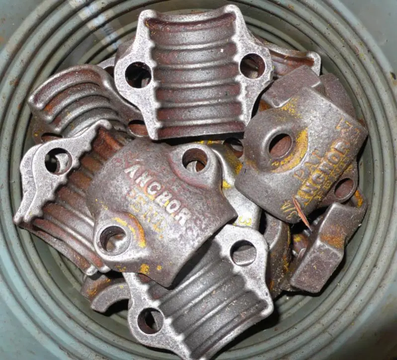

And a few more pictures of before and after.
